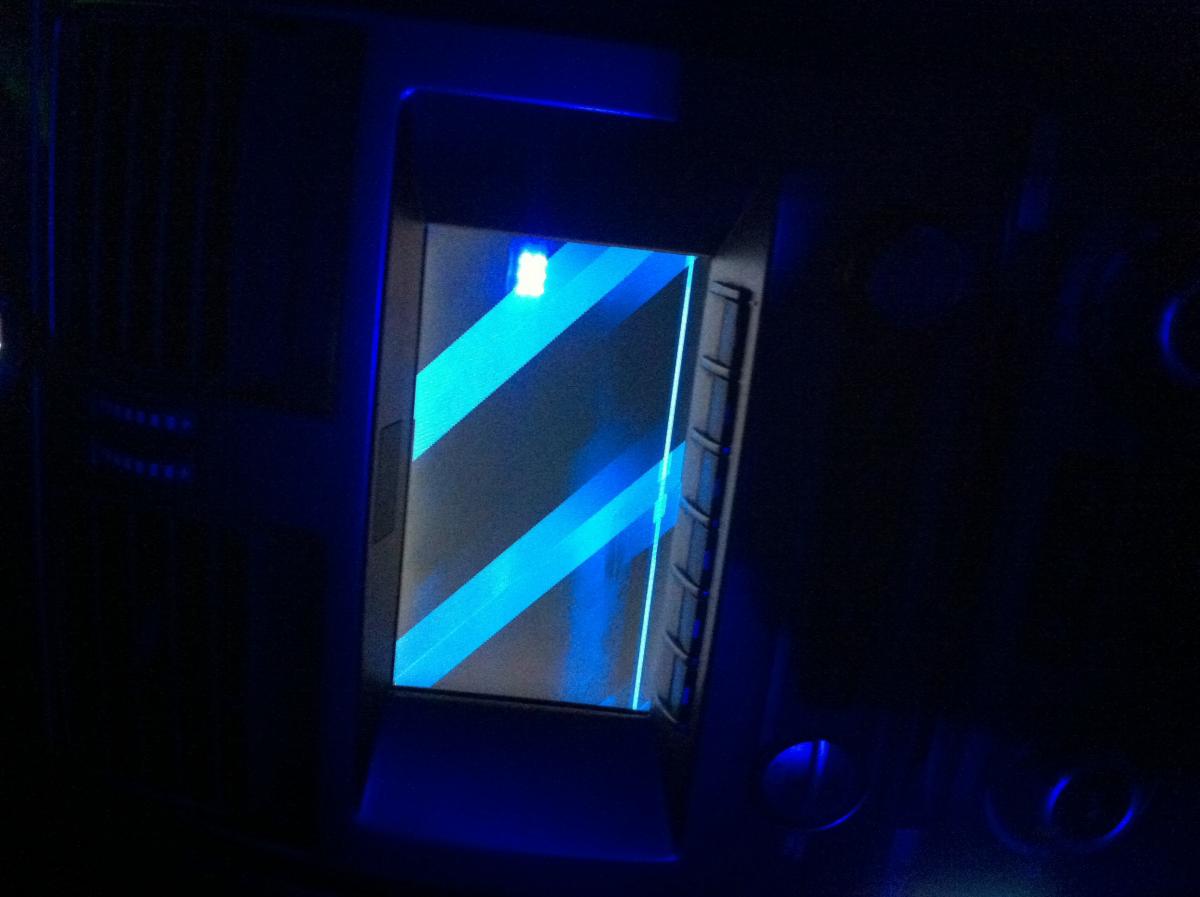

Roley94 Member 114 Member For: 12y 1m Gender: Male Location: Perth Posted 20/03/14 07:10 AM Share Posted 20/03/14 07:10 AM (edited) Just wired up a vga to cga converter to the icc. I plugged my laptop into it to test it but I get scrolling lines across the screen. You can see the desktop image in the back ground but it's not very clear. Could this be interference? Edited 20/03/14 07:17 AM by Roley94 Link to comment Share on other sites More sharing options...

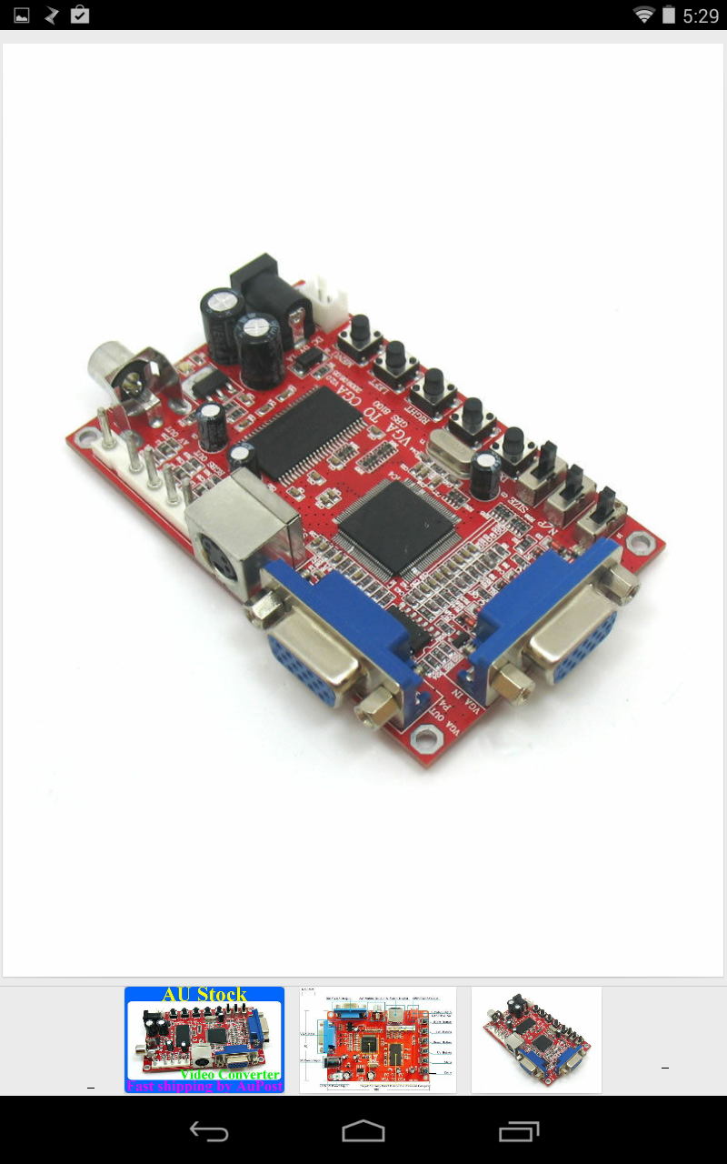

Roley94 Member 114 Member For: 12y 1m Gender: Male Location: Perth Posted 20/03/14 09:34 AM Author Share Posted 20/03/14 09:34 AM I am using this converter which I have seen being used in a few carputer projects. I didn't have any proper screened video cable on hand so I used a piece of USB cable which is screened. I will pick up the proper cable tomorrow and see if that fixes it. Link to comment Share on other sites More sharing options...
Roley94 Member 114 Member For: 12y 1m Gender: Male Location: Perth Posted 21/03/14 10:48 AM Author Share Posted 21/03/14 10:48 AM All fixed, turns out I had the plug wired up opposite. Works great now Link to comment Share on other sites More sharing options...
