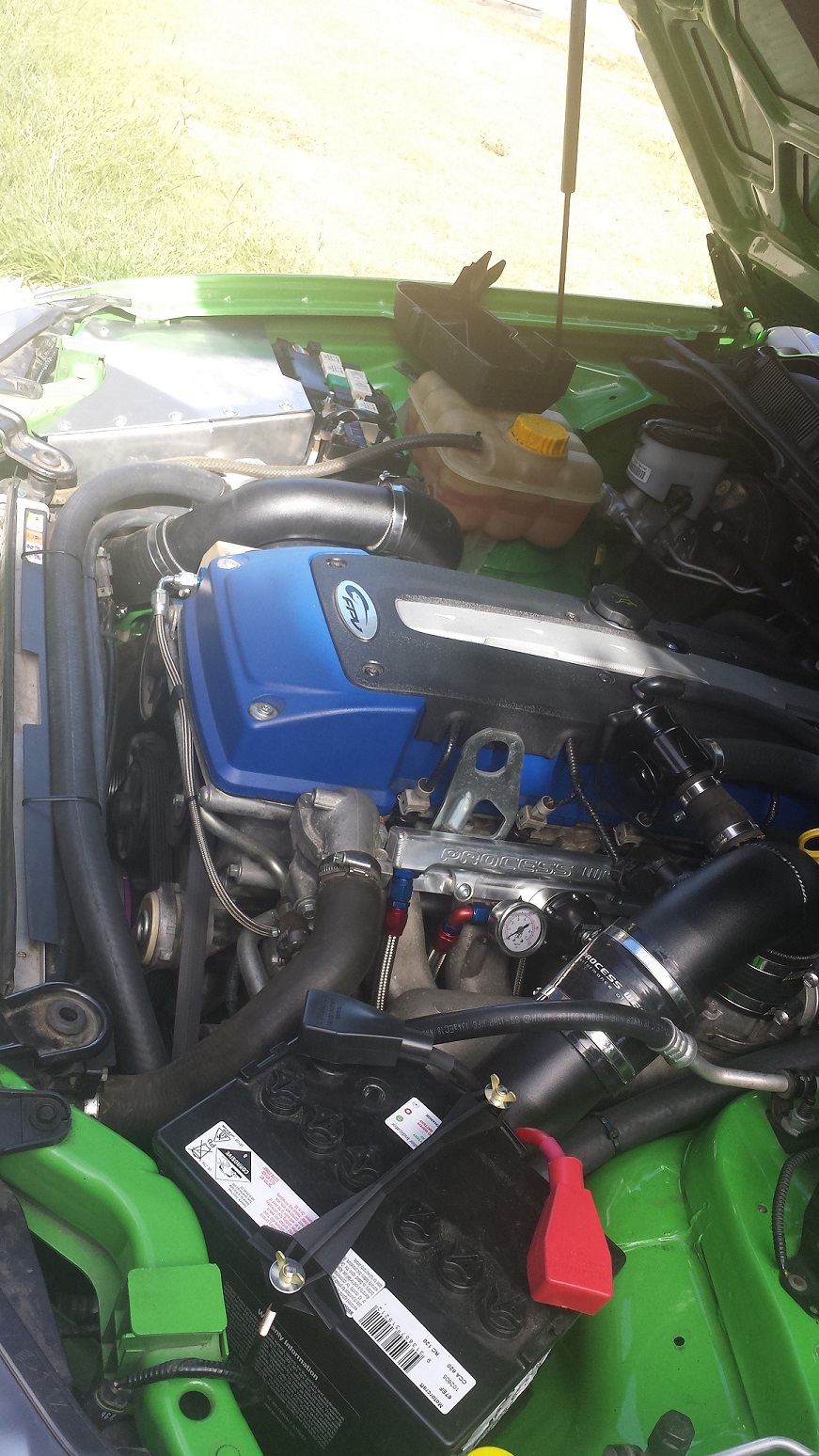

kyle173 Donating Members 774 Member For: 16y 5m 13d Gender: Male Location: brisbane Posted 10/03/14 10:06 AM Author Share Posted 10/03/14 10:06 AM few pics 1 Link to comment https://www.fordxr6turbo.com/forum/topic/87716-ova-310-finally/#findComment-1459610 Share on other sites More sharing options...
f6mark Member 2,908 Member For: 14y 2m 1d Gender: Male Posted 10/03/14 10:18 AM Share Posted 10/03/14 10:18 AM looks Great kyle. what was the PW stage 3 cooler like to fit mate.?? Link to comment https://www.fordxr6turbo.com/forum/topic/87716-ova-310-finally/#findComment-1459612 Share on other sites More sharing options...
kyle173 Donating Members 774 Member For: 16y 5m 13d Gender: Male Location: brisbane Posted 10/03/14 10:19 AM Author Share Posted 10/03/14 10:19 AM easy if my car didn't have a dint in the front had to cut a little more out, now trying to decided what to do next have to fix the crash damage but car just looks like sh*t 1 Link to comment https://www.fordxr6turbo.com/forum/topic/87716-ova-310-finally/#findComment-1459613 Share on other sites More sharing options...
