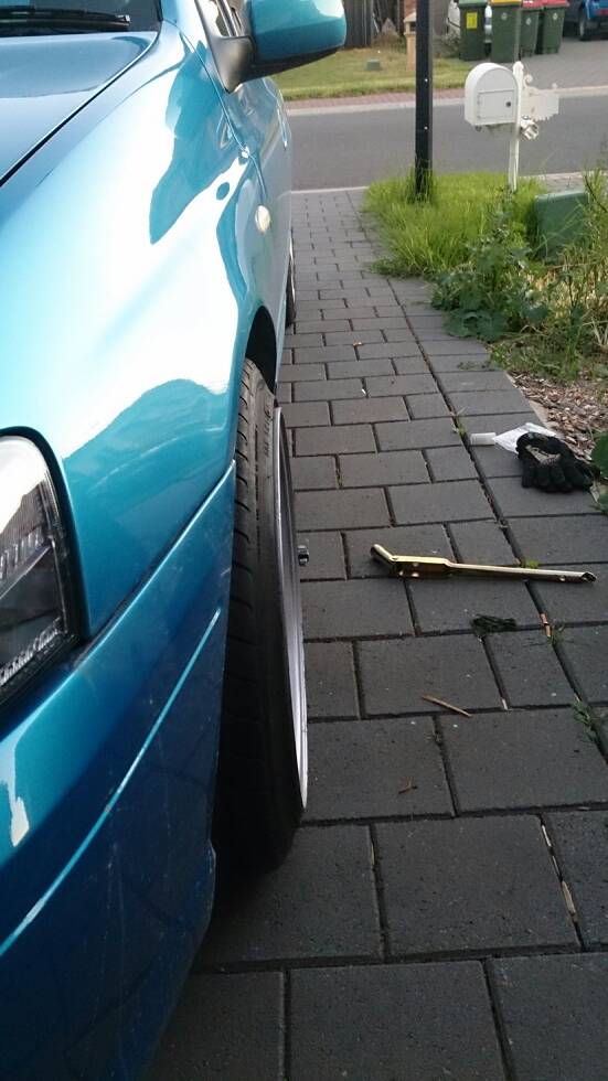

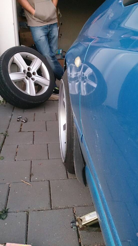

Spyathe Donating Members 872 Member For: 11y 5m 21d Gender: Male Posted 12/04/14 09:03 AM Share Posted 12/04/14 09:03 AM 9.5 +12 Link to comment https://www.fordxr6turbo.com/forum/topic/87502-ba-offsetfitment/page/3/#findComment-1465071 Share on other sites More sharing options...
Future Donating Members 116 Member For: 14y 1m 16d Gender: Male Location: Brisbane Posted 12/04/14 09:24 AM Share Posted 12/04/14 09:24 AM The poke looks nice wouldnt want to hit any bumps lol Link to comment https://www.fordxr6turbo.com/forum/topic/87502-ba-offsetfitment/page/3/#findComment-1465075 Share on other sites More sharing options...
Spyathe Donating Members 872 Member For: 11y 5m 21d Gender: Male Posted 12/04/14 09:45 AM Share Posted 12/04/14 09:45 AM Was only to test fitment and size, I've ordered a set of 18x9.5+35 and I'll need an 8-10mm spacer to clear the strut Link to comment https://www.fordxr6turbo.com/forum/topic/87502-ba-offsetfitment/page/3/#findComment-1465082 Share on other sites More sharing options...
Future Donating Members 116 Member For: 14y 1m 16d Gender: Male Location: Brisbane Posted 12/04/14 11:14 AM Share Posted 12/04/14 11:14 AM Would that make the offset +27 - +25? Link to comment https://www.fordxr6turbo.com/forum/topic/87502-ba-offsetfitment/page/3/#findComment-1465104 Share on other sites More sharing options...
Spyathe Donating Members 872 Member For: 11y 5m 21d Gender: Male Posted 12/04/14 11:32 AM Share Posted 12/04/14 11:32 AM Correct, that gives me 2-4mm clearance to the strut and puts the outer lip 7mm out the guard, but with a 235/40/18 it should sit hella flush. UPS says I should have them in a week :D Link to comment https://www.fordxr6turbo.com/forum/topic/87502-ba-offsetfitment/page/3/#findComment-1465107 Share on other sites More sharing options...
