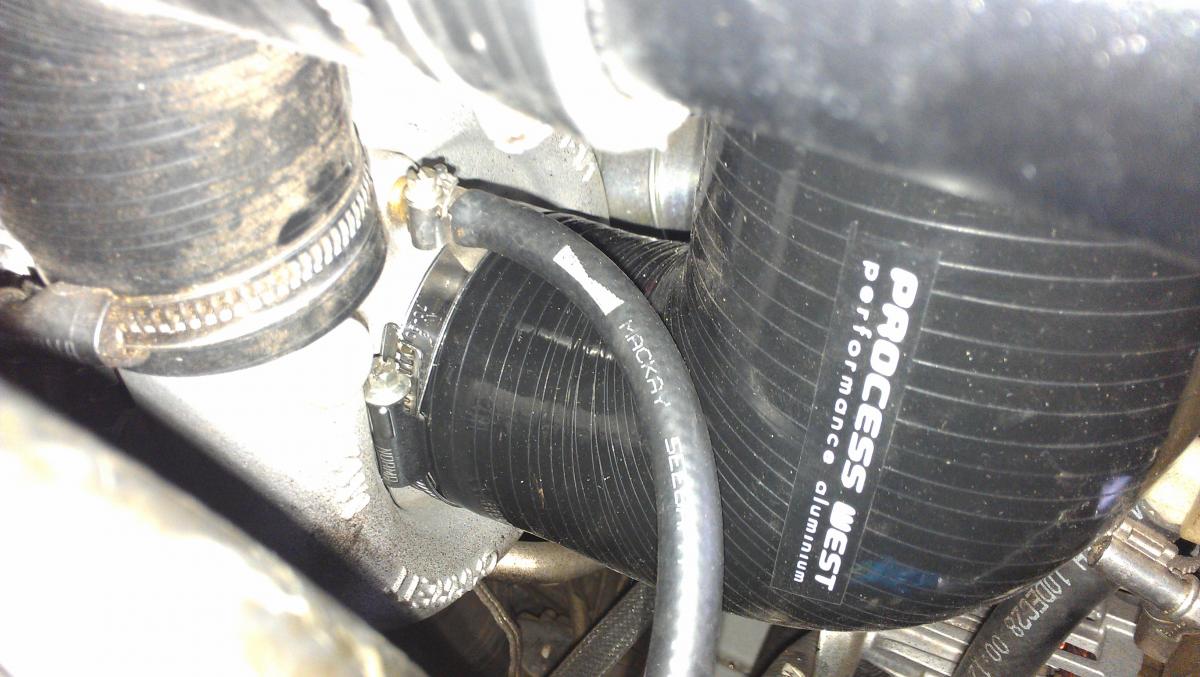

masda74 To Loud Gold Donating Members 4,112 Member For: 13y 4m 18d Gender: Male Location: WA, Perth Posted 31/05/14 10:56 AM Author Share Posted 31/05/14 10:56 AM Well I wanted to do a bit of an update for record keeping.I have taken the time to organise a group buy for the process west air muffler delete.That being said I installed the muffler air delete today. This sure has tidied the engine bay a bit.The one thing that does concern me is the fitting of the rubber piping to the turbo. I just could not get te pipe to go over the back lip of the grove and so it would not slide all the way back.I suspect that because of this, the piping may be to close to the power steering resoviour as per image above.Thoughts? Link to comment https://www.fordxr6turbo.com/forum/topic/86850-fg-xr6t-going-in-for-mods-and-tune-soon/page/4/#findComment-1475459 Share on other sites More sharing options...
Bizkets is Drunk? Too heavy needs boost Member 5,929 Member For: 11y 8m 12d Gender: Male Location: Adelaide Posted 31/05/14 11:47 AM Share Posted 31/05/14 11:47 AM I took my pipe off the turbo to give me some more room and I got it to fit up alright. Just takes a little bit longer. Link to comment https://www.fordxr6turbo.com/forum/topic/86850-fg-xr6t-going-in-for-mods-and-tune-soon/page/4/#findComment-1475478 Share on other sites More sharing options...
masda74 To Loud Gold Donating Members 4,112 Member For: 13y 4m 18d Gender: Male Location: WA, Perth Posted 01/06/14 11:46 AM Author Share Posted 01/06/14 11:46 AM At first I had left the joiner on the turbo and then found that there wasnt enough space to fit the pipe in. Then removed the joiner and tried to fit the rubber pipe directly onto the turbo. It just would not slide all the way to the back.Went on a cruise last night and all piping held up which was good. Link to comment https://www.fordxr6turbo.com/forum/topic/86850-fg-xr6t-going-in-for-mods-and-tune-soon/page/4/#findComment-1475665 Share on other sites More sharing options...
XtRmn8 570Nm @1800rpm Donating Members 2,441 Member For: 21y 6m 27d Gender: Male Location: Perth, WA Posted 01/06/14 01:28 PM Share Posted 01/06/14 01:28 PM To fit the muffle delete up properly I also recommend taking the hot side pipe to dive you more room to adjust and fir properly. 1 Link to comment https://www.fordxr6turbo.com/forum/topic/86850-fg-xr6t-going-in-for-mods-and-tune-soon/page/4/#findComment-1475677 Share on other sites More sharing options...
masda74 To Loud Gold Donating Members 4,112 Member For: 13y 4m 18d Gender: Male Location: WA, Perth Posted 01/06/14 03:20 PM Author Share Posted 01/06/14 03:20 PM Ahh so both of you are talking about the pipe that is to the left of the turbo.You call it hot side pipe, I have no idea what you mean, circle it in a picture and I will know exactly which one you mean. : P Link to comment https://www.fordxr6turbo.com/forum/topic/86850-fg-xr6t-going-in-for-mods-and-tune-soon/page/4/#findComment-1475681 Share on other sites More sharing options...
Bizkets is Drunk? Too heavy needs boost Member 5,929 Member For: 11y 8m 12d Gender: Male Location: Adelaide Posted 01/06/14 09:45 PM Share Posted 01/06/14 09:45 PM the pipe that runs off the top your turbo to your intercooler. just remove that then you have heaps more room. (hot side) Link to comment https://www.fordxr6turbo.com/forum/topic/86850-fg-xr6t-going-in-for-mods-and-tune-soon/page/4/#findComment-1475696 Share on other sites More sharing options...
XtRmn8 570Nm @1800rpm Donating Members 2,441 Member For: 21y 6m 27d Gender: Male Location: Perth, WA Posted 02/06/14 01:29 AM Share Posted 02/06/14 01:29 AM Pharkin phone auto correct.Yea mate the pipe coming out of the turbo just to the left of the intake muffle delete is the hot side pipe. Take that off and it will give you more room to adjust and fit the muffle delete.Just make sure you refit the hot side properly. 1 Link to comment https://www.fordxr6turbo.com/forum/topic/86850-fg-xr6t-going-in-for-mods-and-tune-soon/page/4/#findComment-1475724 Share on other sites More sharing options...
masda74 To Loud Gold Donating Members 4,112 Member For: 13y 4m 18d Gender: Male Location: WA, Perth Posted 02/06/14 01:33 AM Author Share Posted 02/06/14 01:33 AM Roger.learnt something new.I will see what I can do today. 2 Link to comment https://www.fordxr6turbo.com/forum/topic/86850-fg-xr6t-going-in-for-mods-and-tune-soon/page/4/#findComment-1475725 Share on other sites More sharing options...
AzMahoony Hench, but no longer shredded or tanned. Member 3,343 Member For: 18y 21d Gender: Male Location: Canning Vale, W.A Posted 02/06/14 03:33 AM Share Posted 02/06/14 03:33 AM Although I don't advocate it if theres anything touching down there give it a careful bend outta the way.. I had a few things getting in the way when I was fitting the turboside intake and carefully pushed a few things around and eventually *made* the room I neededLove the stocko look! Link to comment https://www.fordxr6turbo.com/forum/topic/86850-fg-xr6t-going-in-for-mods-and-tune-soon/page/4/#findComment-1475758 Share on other sites More sharing options...
mdmatt Member 70 Member For: 11y 1m 27d Gender: Male Location: Perth Posted 02/06/14 03:54 AM Share Posted 02/06/14 03:54 AM the delete pipe was a b!tch to install lol, Took me over an hour, messing around in there in between the hot side piping and the power steering fluid reservoir.XFT checked it all when it was there for a service last week, moved the hose clamp from the power steering hose around as it was pushing into the rubber joiner.Sounds awesome Link to comment https://www.fordxr6turbo.com/forum/topic/86850-fg-xr6t-going-in-for-mods-and-tune-soon/page/4/#findComment-1475762 Share on other sites More sharing options...
