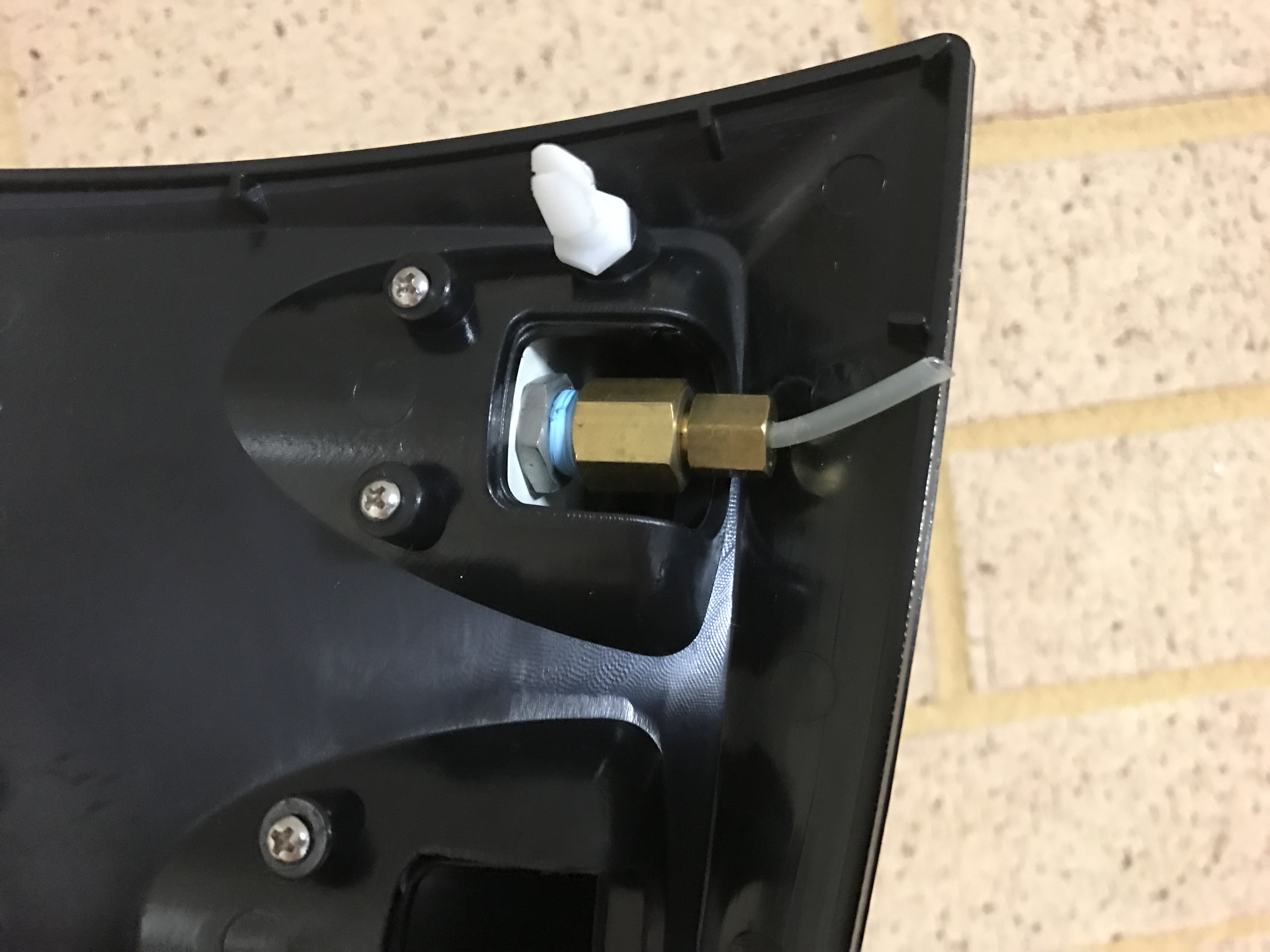

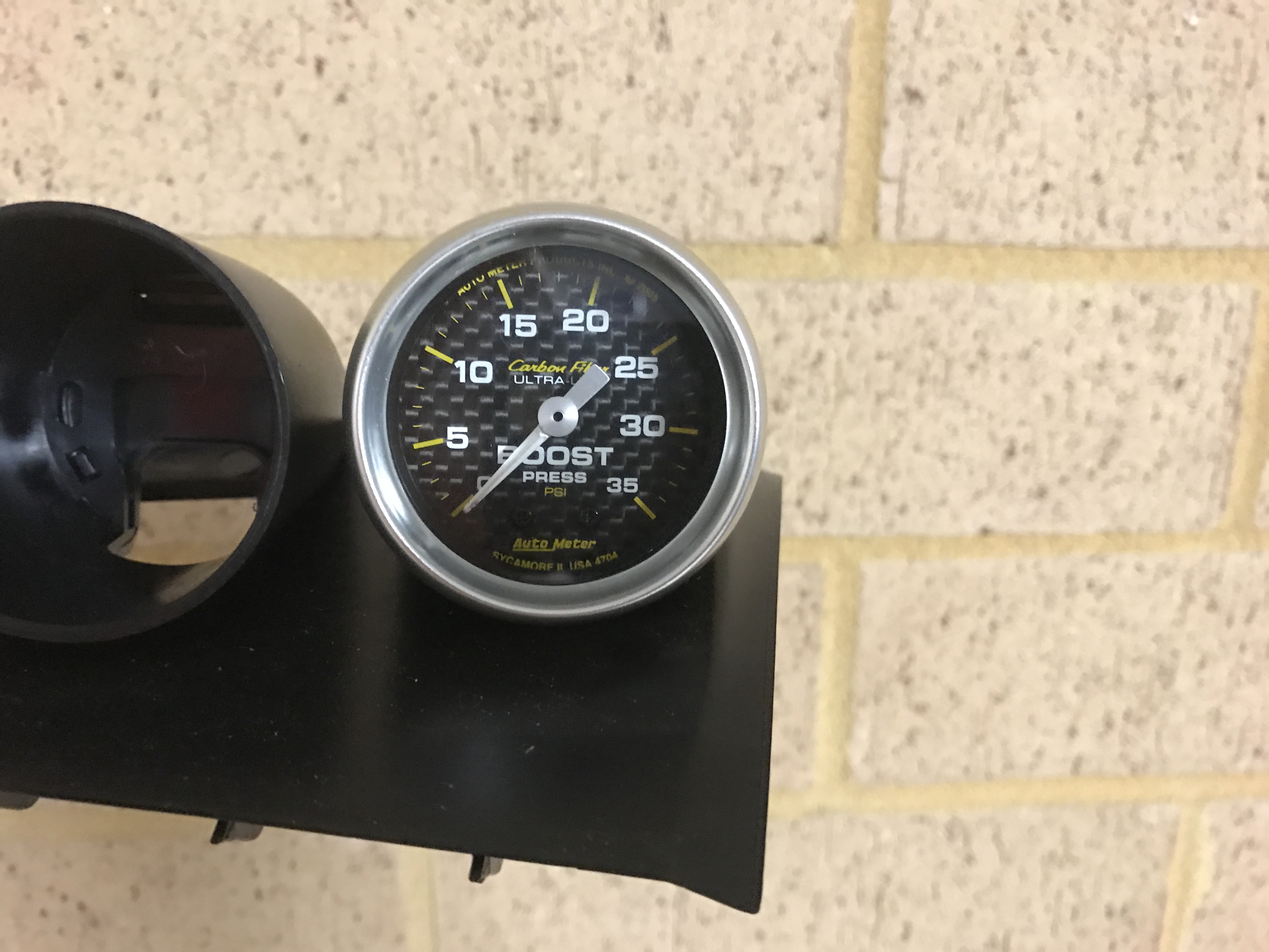

arronm Dropping a turd Gold Donating Members 9,520 Member For: 17y 1m 23d Gender: Male Location: Perth Posted 02/01/17 11:40 AM Share Posted 02/01/17 11:40 AM Mine fitted like this Link to comment Share on other sites More sharing options...
k31th less WHY; more WOT Site Developer 29,042 Member For: 16y 8m 10d Gender: Male Location: Melbourne Posted 02/01/17 11:44 AM Share Posted 02/01/17 11:44 AM clearly magical Link to comment Share on other sites More sharing options...
ROB83R Member 1,632 Member For: 8y 7m Gender: Not Telling Location: Radioactive wasteland Posted 02/01/17 11:48 AM Share Posted 02/01/17 11:48 AM I call bullsh*t! Link to comment Share on other sites More sharing options...

Lennox Member 2,586 Member For: 11y 9m 23d Gender: Male Location: Perth Posted 03/01/17 10:59 PM Share Posted 03/01/17 10:59 PM No they dont.You can't fit a mechanical autometer boost gauge to them without a grinder to cut a big hole in the pod then hack the top of the holderAs chlaxn said 3 years ago... electrical gauges fit fine. I didn't say every 52mm product available from autometer will fit guaranteed or your money back Link to comment Share on other sites More sharing options...
arronm Dropping a turd Gold Donating Members 9,520 Member For: 17y 1m 23d Gender: Male Location: Perth Posted 03/01/17 11:40 PM Share Posted 03/01/17 11:40 PM On 1/2/2017 at 7:48 PM, ROB83R said: I call bullsh*t! What........... Link to comment Share on other sites More sharing options...
