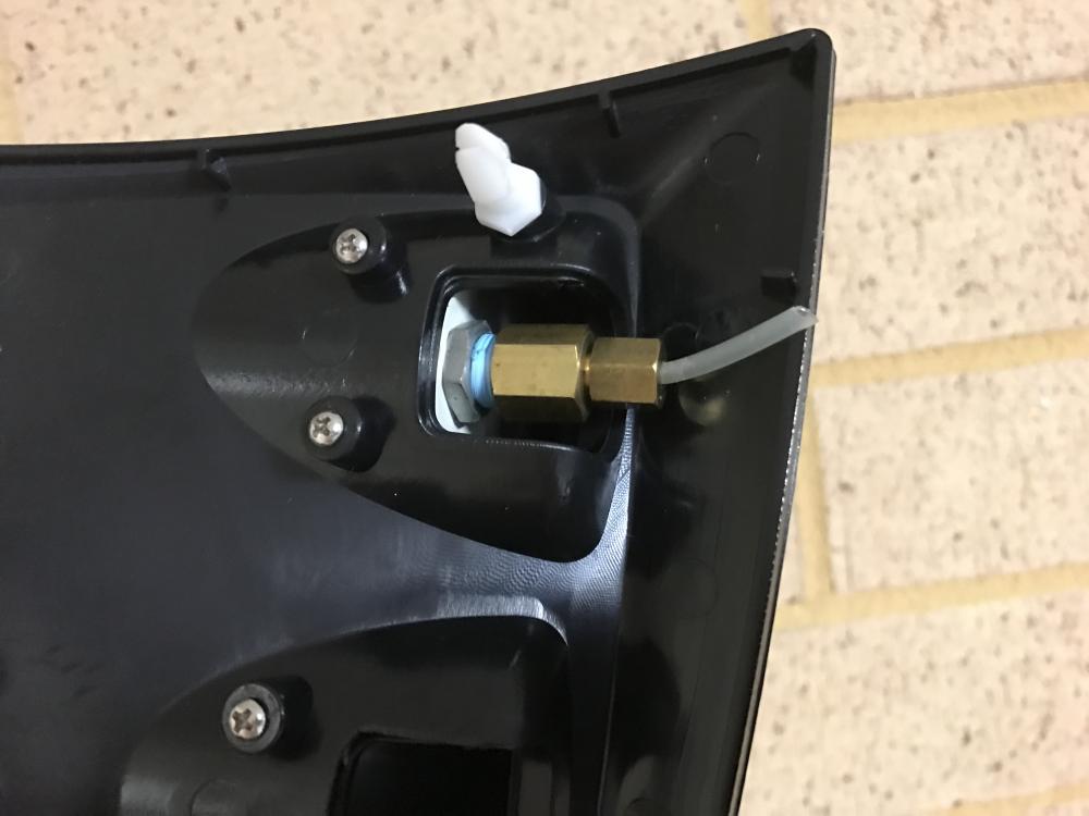

brycieboy Member 6 Member For: 11y 11m 5d Gender: Male Location: carrum downs Posted 09/10/13 09:52 PM Share Posted 09/10/13 09:52 PM (edited) I'm getting one of these. Are they any good. Easy to put in and the 52 mil gauges fit fine?kinda.... the aeroforce gauges needed a few wraps with some tape to make them fit snug. the autometer gauge needed the holder modded to fit. (though its a mechanical boost gauge. mounting bolts had to be cut down, hooles for them had to be made bigger in the cup, the base plate had to be modded as the fittings hit.also fairly easy to fit. I was a little concerned when the instructions said to use a screwdriver or butter knife though.... just dont loose the yellow clips into the dash. Edited 09/10/13 09:53 PM by brycieboy Link to comment Share on other sites More sharing options...
Lennox Member 2,586 Member For: 11y 9m 27d Gender: Male Location: Perth Posted 10/10/13 01:51 AM Share Posted 10/10/13 01:51 AM I have autometer gauges and all I had to do was cut down the brass studs so the backs of the cups would go back on Link to comment Share on other sites More sharing options...
CHLAXN Donating Members 932 Member For: 16y 7m 2d Gender: Male Location: north QLD Posted 10/10/13 02:19 AM Share Posted 10/10/13 02:19 AM kinda.... the aeroforce gauges needed a few wraps with some tape to make them fit snug. the autometer gauge needed the holder modded to fit. (though its a mechanical boost gauge. mounting bolts had to be cut down, hooles for them had to be made bigger in the cup, the base plate had to be modded as the fittings hit.also fairly easy to fit. I was a little concerned when the instructions said to use a screwdriver or butter knife though.... just dont loose the yellow clips into the dash.If you use electric gauges you don't have to modify any thing on the gauge holder. Just have to trim the brass mounting bolts on the gauges shorter. Here is a pic of mine Link to comment Share on other sites More sharing options...

useless Member 259 Member For: 20y 6m 21d Gender: Male Posted 02/01/17 02:32 AM Share Posted 02/01/17 02:32 AM On Wednesday, October 09, 2013 at 7:38 PM, Lennox said: Yes 52mm fit fine, weird how they say on their website that they may not fit? No they dont.You can't fit a mechanical autometer boost gauge to them without a grinder to cut a big hole in the pod then hack the top of the holder Link to comment Share on other sites More sharing options...
