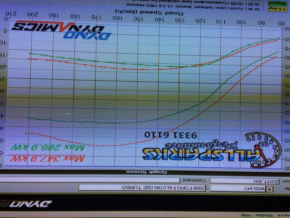

SilkG6ET Member 43 Member For: 15y 5m 9d Posted 25/09/16 12:09 AM Share Posted 25/09/16 12:09 AM (edited) I have been watching this topic for a long time and finally got everything fitted. Gtx35/76r is a wicked street combo. Can't wait to get the radials in and get to Hearhcote. Thanks to all who contributed. e85 tune next Edited 25/09/16 12:16 AM by SilkG6ET Link to comment Share on other sites More sharing options...
SilkG6ET Member 43 Member For: 15y 5m 9d Posted 25/09/16 01:13 AM Share Posted 25/09/16 01:13 AM Upside down graph-weird Link to comment Share on other sites More sharing options...
SilkG6ET Member 43 Member For: 15y 5m 9d Posted 27/09/16 02:30 AM Share Posted 27/09/16 02:30 AM Graph fixed. Link to comment Share on other sites More sharing options...
