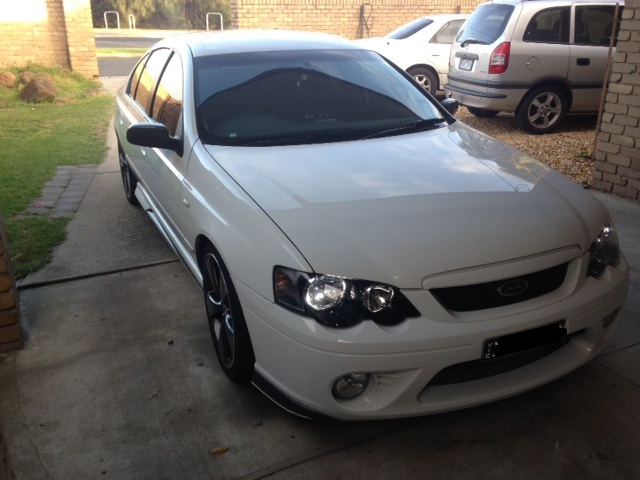

RoVer New Member 12 Member For: 13y 2m 20d Posted 11/09/13 10:14 AM Author Share Posted 11/09/13 10:14 AM Thanks for the kind words guys, small update, fitted the new HDI GT2 intercooler yesterday.Removal of front barnew cooler fittedExcuse the dirty engine bay.front bar back onMinor difference in power, however the engine does feel crisper/sharper under WOT, intake noise has deepened. Not the best cooler out there, but core looks sturdy. Hoping will be ok for the power levels I'm chasing (320~350rwkw. street driven)Next is Bosch 044 fuel pump, then book it in for a tune.Cheers. Link to comment Share on other sites More sharing options...
