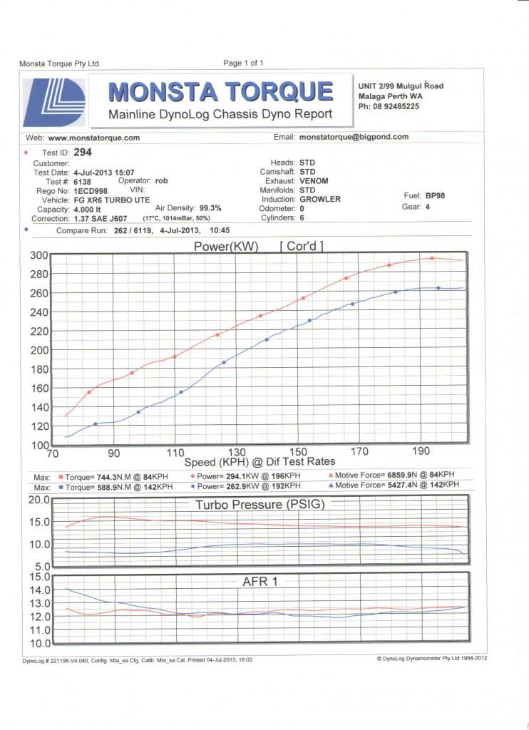

jules_1972 Member 39 Member For: 15y 6m 26d Gender: Male Posted 08/08/13 01:17 PM Share Posted 08/08/13 01:17 PM (edited) Compares pretty close to my Fg tuned by Monsta Torque.Similar mods for power, also boost curves very close to.http://i175.photobucket.com/albums/w136/jules_1972/XR6%20Mods/FGXR6Turbo_Tune_zps06a78f22.jpeg Edited 08/08/13 01:19 PM by jules_1972 Link to comment https://www.fordxr6turbo.com/forum/topic/85881-can-someone-explain-this/page/4/#findComment-1414135 Share on other sites More sharing options...
wa g6et Member 657 Member For: 14y 28d Gender: Male Location: Perth NOR Posted 08/08/13 02:15 PM Share Posted 08/08/13 02:15 PM Hey jules my MT tune with similar mods looks a lot like yours too, I have a 8psi actuator and my tune peaks around 15-16psi tapers to just above 12. Rob said he pulled the boost at the top as it wasn't going to much more power. I only have the stock CAI witha k&n but with a turbo back 3.5 Xforce so maybe with turbo side intake could have gone a few more rwkw. However I'm quite happy with what I have, torque and power both come on early making for a fun drive.When I had my surge fitted tha car was put on the dyno and just needed the AFRs tweaked a little( from memory described as a little fat).I added the PW surge/ PW2 IC/Nizpro overboost valve/flapper mod as security for more consistent, safer power on the street. Not a single dyno run.Just remember when others have to refuel at 1/2 tank you can still power down safely to the low fuel light!!! And still have decent power on a stinking hot day. 1 Link to comment https://www.fordxr6turbo.com/forum/topic/85881-can-someone-explain-this/page/4/#findComment-1414139 Share on other sites More sharing options...
jules_1972 Member 39 Member For: 15y 6m 26d Gender: Male Posted 08/08/13 02:21 PM Share Posted 08/08/13 02:21 PM Cool!Think I need at least a Stepped either a PWR or Process west cooler. Link to comment https://www.fordxr6turbo.com/forum/topic/85881-can-someone-explain-this/page/4/#findComment-1414140 Share on other sites More sharing options...
