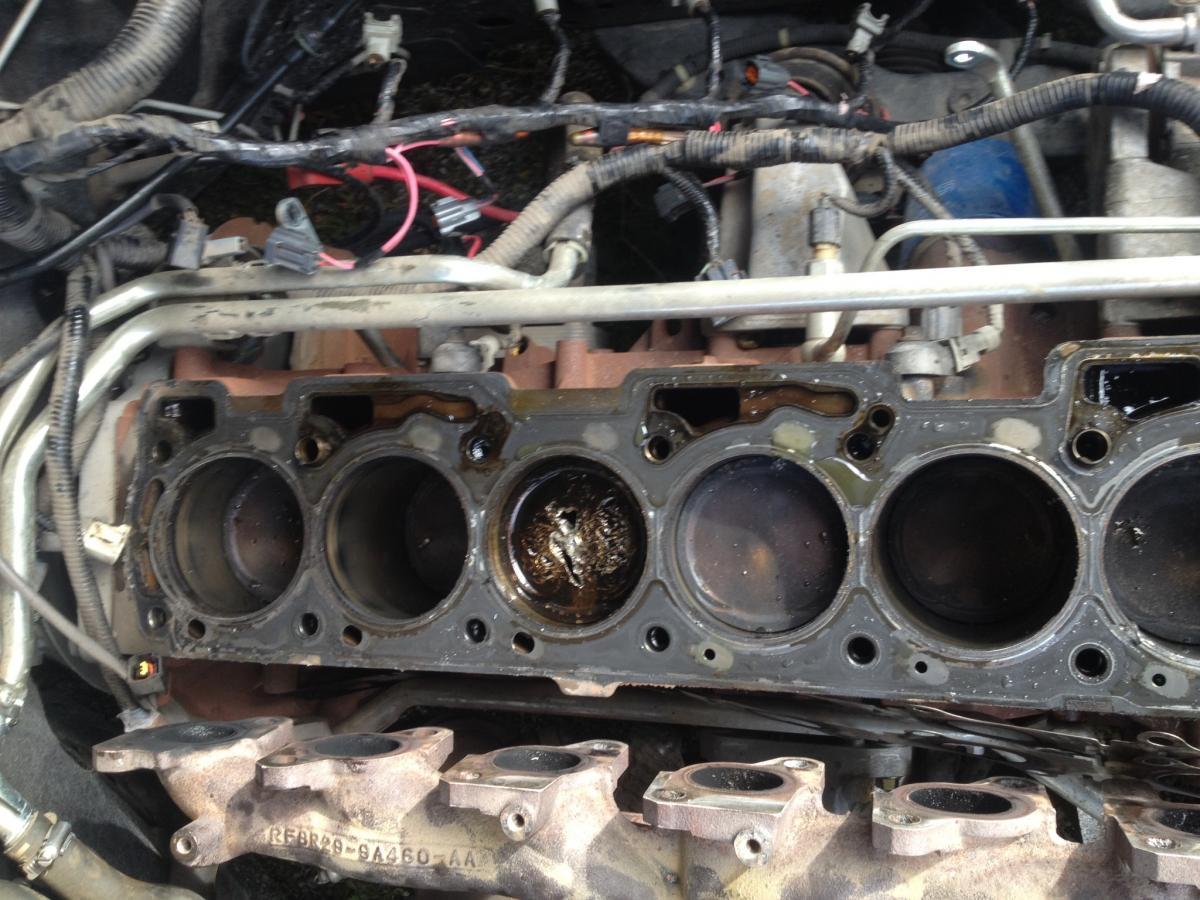

arronm Dropping a turd Gold Donating Members 9,520 Member For: 17y 6m 6d Gender: Male Location: Perth Posted 14/08/13 01:13 PM Share Posted 14/08/13 01:13 PM Isnt the piston relief's for the inlet valves. So the exhaust valves have touched the pistons. But isnt the failed valve an inlet valve. Link to comment https://www.fordxr6turbo.com/forum/topic/85759-fg-droped-a-valve/page/9/#findComment-1415931 Share on other sites More sharing options...

blueprintbullet Donating Members 163 Member For: 17y 2m Gender: Male Location: Wanneroo Posted 14/08/13 10:13 PM Author Share Posted 14/08/13 10:13 PM Isnt the piston relief's for the inlet valves. So the exhaust valves have touched the pistons. But isnt the failed valve an inlet valve.Nope the reliefs are for the exhaust have this pic which shows them on the exhaust Link to comment https://www.fordxr6turbo.com/forum/topic/85759-fg-droped-a-valve/page/9/#findComment-1415971 Share on other sites More sharing options...

arronm Dropping a turd Gold Donating Members 9,520 Member For: 17y 6m 6d Gender: Male Location: Perth Posted 15/08/13 12:41 AM Share Posted 15/08/13 12:41 AM Nope the reliefs are for the exhaust have this pic which shows them on the exhaustimage.jpgYes I see, then things add up. How many pistons show impact damage of the inlet valves Link to comment https://www.fordxr6turbo.com/forum/topic/85759-fg-droped-a-valve/page/9/#findComment-1416002 Share on other sites More sharing options...
blueprintbullet Donating Members 163 Member For: 17y 2m Gender: Male Location: Wanneroo Posted 15/08/13 02:31 AM Author Share Posted 15/08/13 02:31 AM All of them Link to comment https://www.fordxr6turbo.com/forum/topic/85759-fg-droped-a-valve/page/9/#findComment-1416039 Share on other sites More sharing options...

arronm Dropping a turd Gold Donating Members 9,520 Member For: 17y 6m 6d Gender: Male Location: Perth Posted 17/08/13 12:45 AM Share Posted 17/08/13 12:45 AM (edited) Either way something has allowed the inlet valves to make contact with all the pistons and it is highly unlikely this occurred as a consequence of the failed valve .That said the pistons hitting the valves and the one inlet valve failing maybe the same event.Crack test all the other valves, SOME may find fatigue cracks. Edited 17/08/13 12:48 AM by arronm Link to comment https://www.fordxr6turbo.com/forum/topic/85759-fg-droped-a-valve/page/9/#findComment-1416531 Share on other sites More sharing options...
