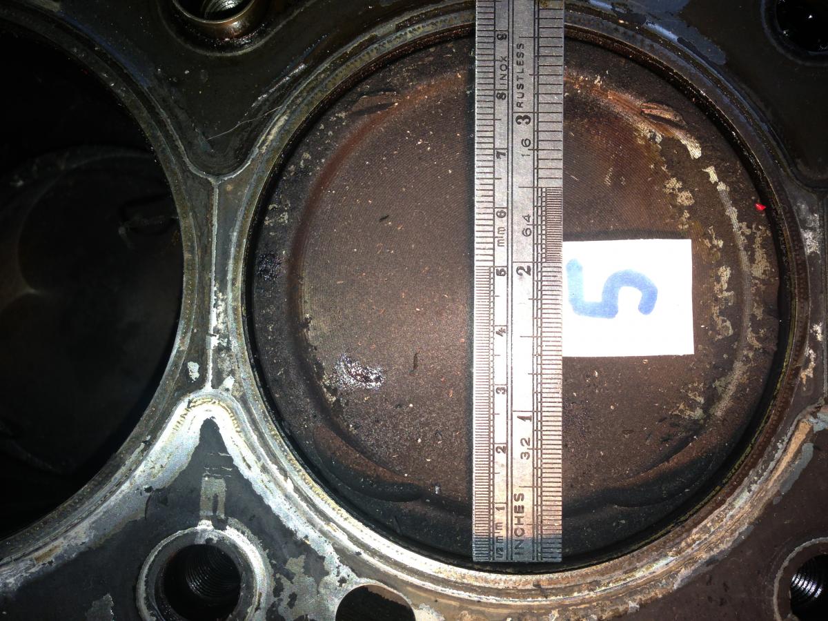

blueprintbullet Donating Members 163 Member For: 17y 1m 14d Gender: Male Location: Wanneroo Posted 14/08/13 09:55 AM Author Share Posted 14/08/13 09:55 AM Spoke to ford HQ yesterday still no report from Nuford so I made a report giving them all the relevent info and pics. They got back to me today and were fairly helpful but have said that they will only warrant manufacture issues and this is a workmanship issue which I will have to take up with Nuford. I questioned them in regards to if the chain guide replacement was repaired to there standards and they said that the repair would have been authorised by them but they would have only been able to go on the info from the Nuford mechanic and they need to warrant there own work.I also got hold of the report that was made when the guide failed and it mentioned that the timing was out by 2 teeth on both cams but no mention as to weather it was two teeth advanced or retarded. I know many have said that they have seen them retarded even further with no damage but if they were advanced the intake valves will be more likely to contact the pistons. As far as I know the intake valves start to open just prior to the piston hitting the TDC so if they opened earlier then the valves could be nearly all the way opened by the time the piston hits TDC.I'm sure there is some camshaft guru out there that can validate what I am saying? Link to comment https://www.fordxr6turbo.com/forum/topic/85759-fg-droped-a-valve/page/8/#findComment-1415859 Share on other sites More sharing options...
dustyae86 Member 46 Member For: 13y 6m 11d Posted 14/08/13 10:35 AM Share Posted 14/08/13 10:35 AM No disrespect inteneded to some of the other people on here, but I'm 100% with ratter on this one, when an engine is built the valves are seated to form a SEAL on the head, if like has been stated the valves were bent in the past it would be very noticeable, generally when a valve hits a piston it will generally break a bit off the head of the valve or else bend the shaft not allowing the valve to retract properly and then causing it to break the head off, this wouldn't happen years later, it would happen minutes later.Also regarding cars jumping teeth, it was my car that jumped 2 teeth and sounded absolutely horrible!! but in my opinion also it is exactly what was stated that causes it, sudden jumping off of the throttle, when mine did it, I had just came out of around about and accelerated in second then made alast minute decision to get red rooster and jumped off the throttle quickly at around 4000rpm. so the theory is, that the sudden jump makes the tensioner retract back but it still has quiet a bit of mechanical force on the engine then bam jumped teeth. Is there a fix? I honestly don't think so, just driving style I think, until someone releases a slightly stronger tensioner (which could cause it's own issues) my chain guide didn't really have any big chunks out of it, but it was a case of better safe than sorry.So there is my rant, so in the opinion of 2 qualified mechanics saying it wasn't due to the timing issue it's not looking great sorry to say 1 Link to comment https://www.fordxr6turbo.com/forum/topic/85759-fg-droped-a-valve/page/8/#findComment-1415875 Share on other sites More sharing options...
blueprintbullet Donating Members 163 Member For: 17y 1m 14d Gender: Male Location: Wanneroo Posted 14/08/13 10:52 AM Author Share Posted 14/08/13 10:52 AM (edited) I too don't want to upset anyone as you have all been helpful but I have the proof " these valves are bent" they also have a funny wear pattern on the stem as though they have worn on one side add to this when you press the valve back into the seat with your hand it sticks there because it has cocked itself into place, plus what would you expect to have happened to these valves as they have obviously hit the pistons Edited 14/08/13 10:59 AM by blueprintbullet Link to comment https://www.fordxr6turbo.com/forum/topic/85759-fg-droped-a-valve/page/8/#findComment-1415885 Share on other sites More sharing options...
