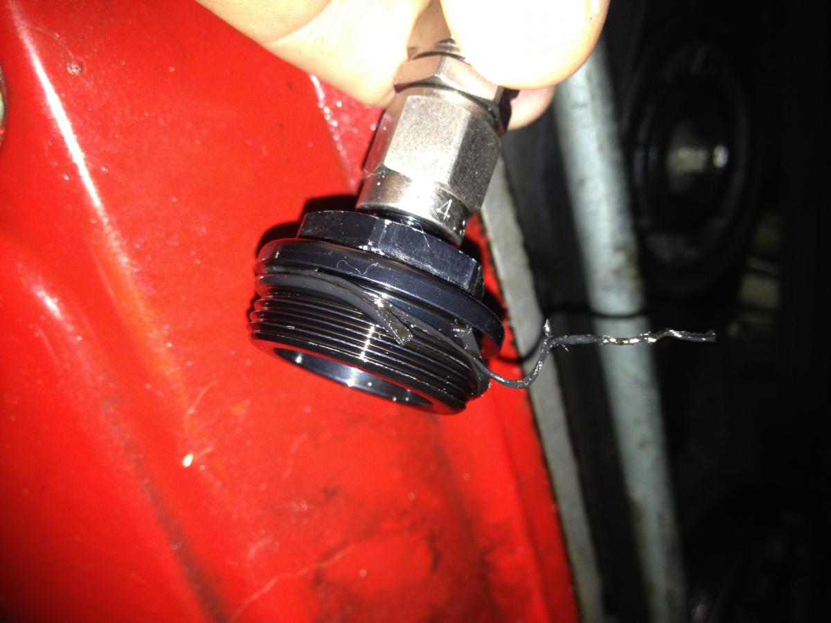

Treay Member 29 Member For: 16y 9m 16d Gender: Male Location: Stockton, NSW Posted 19/07/13 06:24 PM Author Share Posted 19/07/13 06:24 PM (edited) What an epic week. I punched a shock through the tower on my f truck so had to fix it after work lastnight before heading across to Newcastle to pick the trailer up and then load the g6 on and head to liverpool for these repairs to be repaired. Hit a Roo on my way home so my f truck has a slightly dented bar and my led light bar was left dragging along the road (still works though!). Picked the trailer up when I finally got to Newcastle and then headed to my place to pick up the g6... The bloody ramps were too short to get my car on!. Returned the trailer to find out I won't get a cent of my $140 back despite only having it for 1hr.So stuff it. Ill just let the workshop off the hook and get it fixed in Newcastle!. I just pulled the oil filter apart and the O ring was squashed so bad it was cut practically right through!. Think ill order the earls filter and fit it after all.Think ill just get some sleep for now as my head isn't right at the moment!.All that for a bloody o ring and probably a temporarily stuck footfall valve! Haha Edited 19/07/13 06:32 PM by Treay Link to comment https://www.fordxr6turbo.com/forum/topic/85617-yet-another-turbo-emergency/page/3/#findComment-1408343 Share on other sites More sharing options...

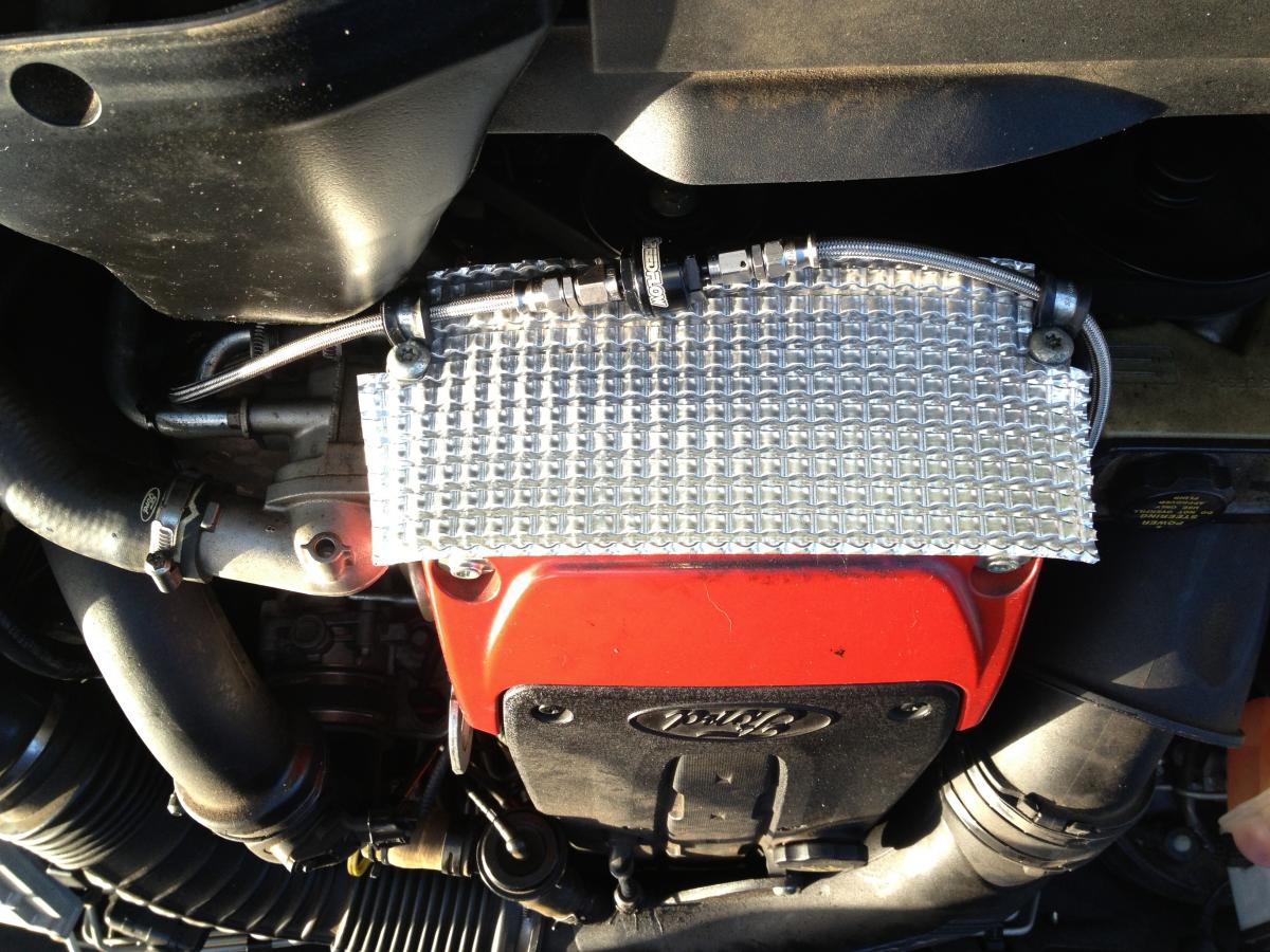

Treay Member 29 Member For: 16y 9m 16d Gender: Male Location: Stockton, NSW Posted 20/07/13 12:23 PM Author Share Posted 20/07/13 12:23 PM Yeah I'm just over it. Purchased high pressure and high temp o rings today and put some heat shielding up to mount it on as the location it is in that little filter gets sh*t hot!.Took it for a drive with a combination of stop start and open road over 2 hours and it still had no leaks so I'm hoping its fixed. I didn't have time to wash the engine bay today as I had to get back to work ASAP so with another 500 trip ahead of me I parked it up as is til I get back next week. Then ill give it a big going over.Cheers guys. Link to comment https://www.fordxr6turbo.com/forum/topic/85617-yet-another-turbo-emergency/page/3/#findComment-1408556 Share on other sites More sharing options...
