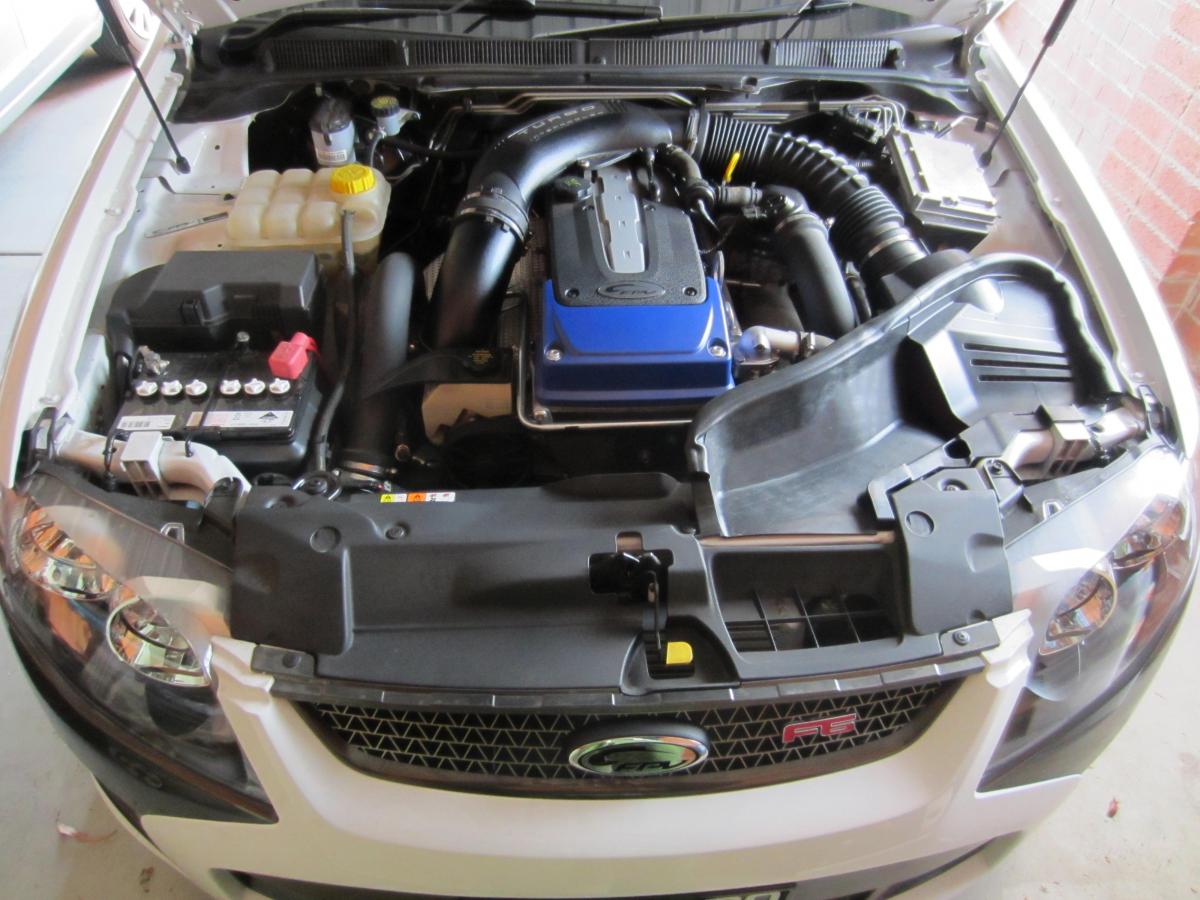

timetaker Donating Members 217 Member For: 14y 5m 6d Gender: Male Posted 07/07/13 03:52 AM Share Posted 07/07/13 03:52 AM I have the KPM Street fighter CAI and recently also installed a Process West muffler delete intake pipe.They are the only mods I have on my FG F6.There is an increase in induction noise and when changing gears more of that "kischhh" noise..ha!..ha!.I have noticed more response down low andthe pickup through the gears is a little more sprightly.It feels like the turbo is spooling up a little faster with the muffler delete intake pipe.???I want to make a brief sound/vid recording on the sound,but for now just a couple of pictures will suffice Link to comment https://www.fordxr6turbo.com/forum/topic/85515-any-gain-from-air-box-mods/page/2/#findComment-1404692 Share on other sites More sharing options...
