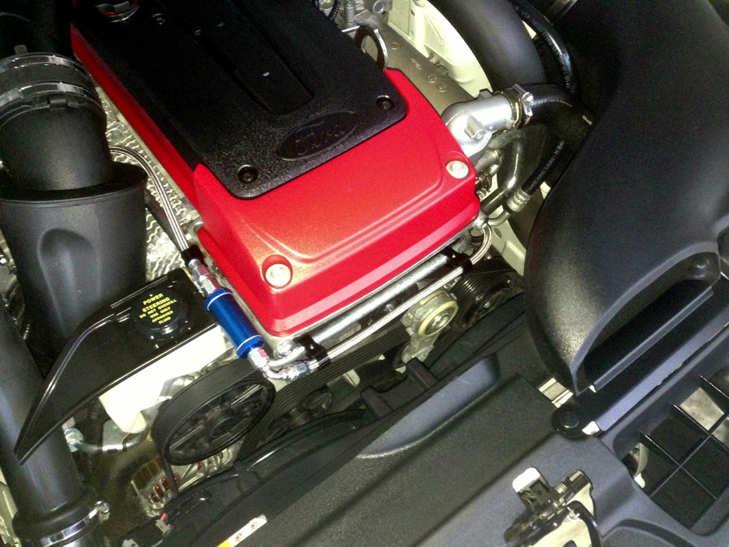

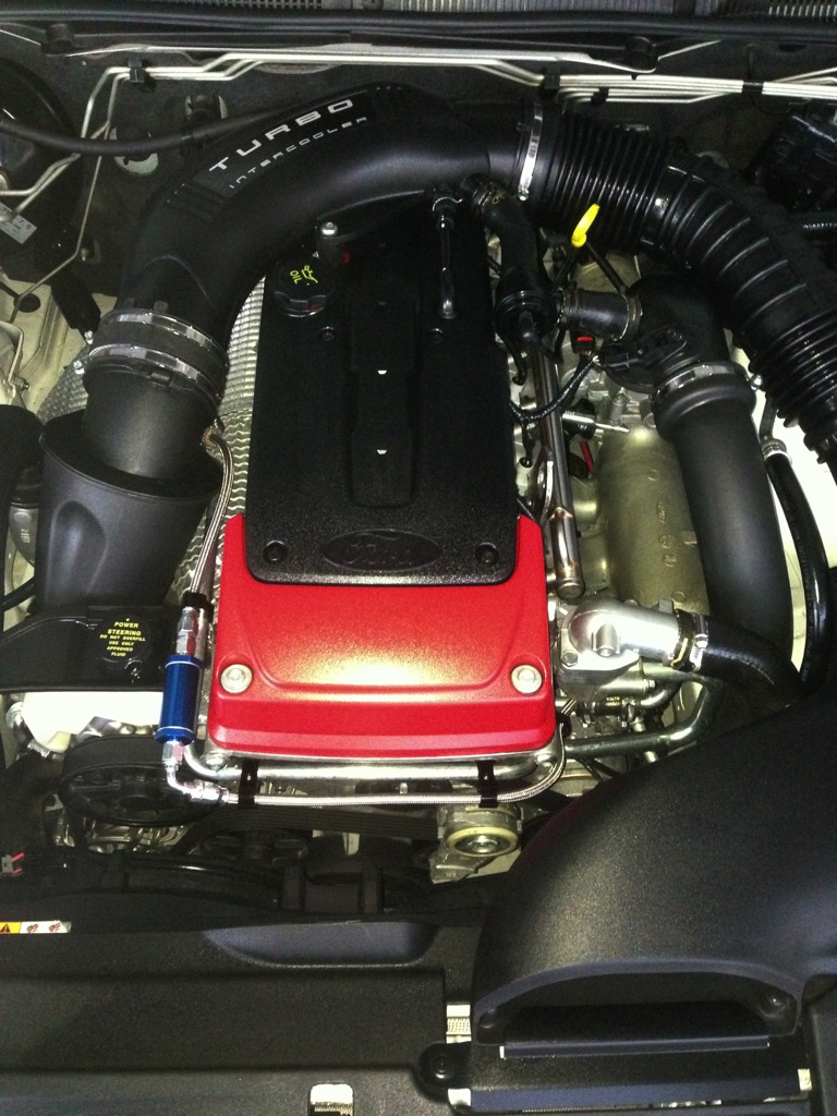

GeGe6 Donating Members 1,980 Member For: 12y 9m 7d Gender: Male Location: Perth, SOR Posted 14/07/13 04:41 AM Share Posted 14/07/13 04:41 AM (edited) I know some of you guys are planning to to turbo oil line and thought you might like part number off anodized clamps I used to position my earls kit.Part number is AF 156-08BLKClamp ID is about 12mm which fits to the steel line running to turbo (cooling line I think it is).If you are using a earls kit which from memory might be -6 Teflon braid with a OD of about 8mm I think.Given this I just pack out the braid line with rubber to secure.Also a link for EBay or can order through Coventrys or any stockist of Areoflow.http://m.ebay.com.au/search?cmd=SKW&kw=AF+156-08blk&pgn=1 Edited 14/07/13 04:46 AM by GeGe6 Link to comment https://www.fordxr6turbo.com/forum/topic/85514-wa-xr6t-maintenance-day-round-3/page/6/#findComment-1406629 Share on other sites More sharing options...
GeGe6 Donating Members 1,980 Member For: 12y 9m 7d Gender: Male Location: Perth, SOR Posted 14/07/13 04:59 AM Share Posted 14/07/13 04:59 AM Photo of turbo oil line clamps. Tried to add to last post but couldn't. Link to comment https://www.fordxr6turbo.com/forum/topic/85514-wa-xr6t-maintenance-day-round-3/page/6/#findComment-1406635 Share on other sites More sharing options...
arronm Dropping a turd Gold Donating Members 9,520 Member For: 17y 5m 18d Gender: Male Location: Perth Posted 14/07/13 05:09 AM Share Posted 14/07/13 05:09 AM Good idea but cable ties are cheaper. Someone should buy a section of heat sleeve and everyone can share it.Like this. I have a whole packet I will bring some along (cable ties) 1 Link to comment https://www.fordxr6turbo.com/forum/topic/85514-wa-xr6t-maintenance-day-round-3/page/6/#findComment-1406638 Share on other sites More sharing options...
Boganspeed Will do skids for food Silver Donating Members 1,177 Member For: 13y 5m 10d Gender: Male Location: Perth SOR Posted 14/07/13 11:10 AM Share Posted 14/07/13 11:10 AM Those clamps do look nice.Pricey, but nice. Link to comment https://www.fordxr6turbo.com/forum/topic/85514-wa-xr6t-maintenance-day-round-3/page/6/#findComment-1406754 Share on other sites More sharing options...
masda74 To Loud Gold Donating Members 4,112 Member For: 13y 4m 15d Gender: Male Location: WA, Perth Posted 14/07/13 11:17 AM Share Posted 14/07/13 11:17 AM GeGe6, how much and where from? Some sellers on fleabay are asking $17 each. Link to comment https://www.fordxr6turbo.com/forum/topic/85514-wa-xr6t-maintenance-day-round-3/page/6/#findComment-1406756 Share on other sites More sharing options...
GeGe6 Donating Members 1,980 Member For: 12y 9m 7d Gender: Male Location: Perth, SOR Posted 14/07/13 11:39 AM Share Posted 14/07/13 11:39 AM Got mine from Coventry's about the same price. I did get them to express post and had them in two days. Link to comment https://www.fordxr6turbo.com/forum/topic/85514-wa-xr6t-maintenance-day-round-3/page/6/#findComment-1406762 Share on other sites More sharing options...
