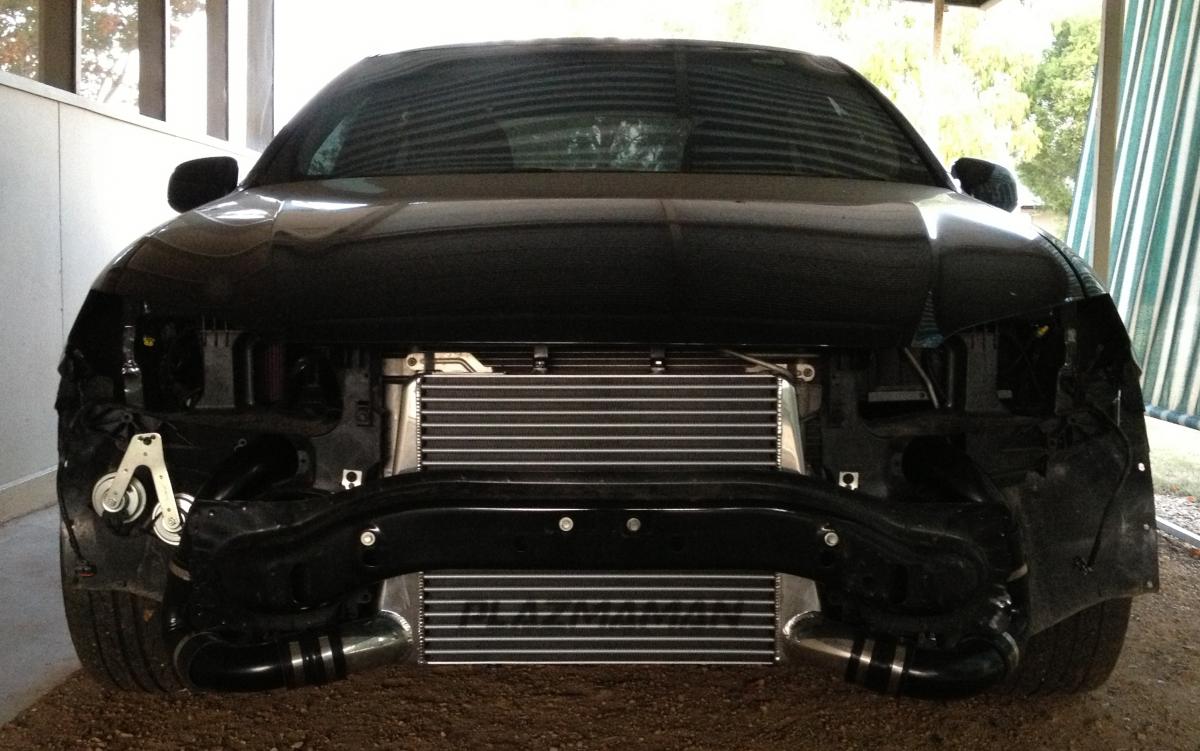

Phoon508 Member 188 Member For: 12y 6m 22d Posted 20/06/13 11:51 AM Share Posted 20/06/13 11:51 AM Hey guys. Looking to chase 340-360rwkw in the near future and a mate of mine has a plazmaman 1000hp cooler which he is happy to sell to me super cheap. I'm just worried that it is too big and will create a heap of lag. Is this intercooler too big for the power I am after?Thanks Link to comment https://www.fordxr6turbo.com/forum/topic/85357-plaz-1000hp-cooler/ Share on other sites More sharing options...
mummba Member 525 Member For: 15y 3m 24d Gender: Male Location: perth Posted 20/06/13 01:35 PM Share Posted 20/06/13 01:35 PM wicked cooler, how old is it?? as they not long ago released there new 1000hp cooler with a new core..still awesome cooler, main thing to change is they come with 3' inlet and outlet and most cooler pipe kits are 2.5' just need 2 reducerslucky to get it cheap if you can Link to comment https://www.fordxr6turbo.com/forum/topic/85357-plaz-1000hp-cooler/#findComment-1399922 Share on other sites More sharing options...
AdamIan69 Bronze Donating Members 401 Member For: 12y 2m 9d Gender: Male Location: WA Posted 20/06/13 01:48 PM Share Posted 20/06/13 01:48 PM Ye mate I have also heard they are a great cooler. I picked mine second hand aswell. Plumbing from nizpro is just under $700. I would be sceptical if he was running water injection before the cooler or running water onto it. I have seen intakes start to corrode because of the minerals in the water. Link to comment https://www.fordxr6turbo.com/forum/topic/85357-plaz-1000hp-cooler/#findComment-1399927 Share on other sites More sharing options...
JETURBO ...JD TUNING ADELAIDE... Gold Donating Members 23,708 Member For: 17y 30d Gender: Male Location: Adelaide Posted 20/06/13 02:21 PM Share Posted 20/06/13 02:21 PM Way to big Sell it to me Link to comment https://www.fordxr6turbo.com/forum/topic/85357-plaz-1000hp-cooler/#findComment-1399939 Share on other sites More sharing options...
Phoon508 Member 188 Member For: 12y 6m 22d Posted 20/06/13 07:30 PM Author Share Posted 20/06/13 07:30 PM He said its only 11 months old and it has 3 inch inlet/outlets. Does that mean its the new series? Link to comment https://www.fordxr6turbo.com/forum/topic/85357-plaz-1000hp-cooler/#findComment-1399948 Share on other sites More sharing options...
HSV ETR Member 131 Member For: 12y 11m 8d Gender: Male Location: Brisbane Posted 21/06/13 05:46 AM Share Posted 21/06/13 05:46 AM Mate I got the 1200hp one and simular power and don't have any lag problems Link to comment https://www.fordxr6turbo.com/forum/topic/85357-plaz-1000hp-cooler/#findComment-1400069 Share on other sites More sharing options...
Phoon508 Member 188 Member For: 12y 6m 22d Posted 21/06/13 08:35 AM Author Share Posted 21/06/13 08:35 AM Beauty that's good to know. What intake are you running mate? Under battery or the 4 inch jobbie? Link to comment https://www.fordxr6turbo.com/forum/topic/85357-plaz-1000hp-cooler/#findComment-1400101 Share on other sites More sharing options...
Kroozin Menace Donating Members 1,990 Member For: 14y 2m 9d Gender: Male Location: Sydney Posted 21/06/13 09:11 AM Share Posted 21/06/13 09:11 AM 4" is best but the ubp will net you your 350 too Link to comment https://www.fordxr6turbo.com/forum/topic/85357-plaz-1000hp-cooler/#findComment-1400125 Share on other sites More sharing options...
AdamIan69 Bronze Donating Members 401 Member For: 12y 2m 9d Gender: Male Location: WA Posted 22/06/13 01:31 AM Share Posted 22/06/13 01:31 AM I am relocating the battery to the boot or other side of the engine bay Link to comment https://www.fordxr6turbo.com/forum/topic/85357-plaz-1000hp-cooler/#findComment-1400311 Share on other sites More sharing options...
