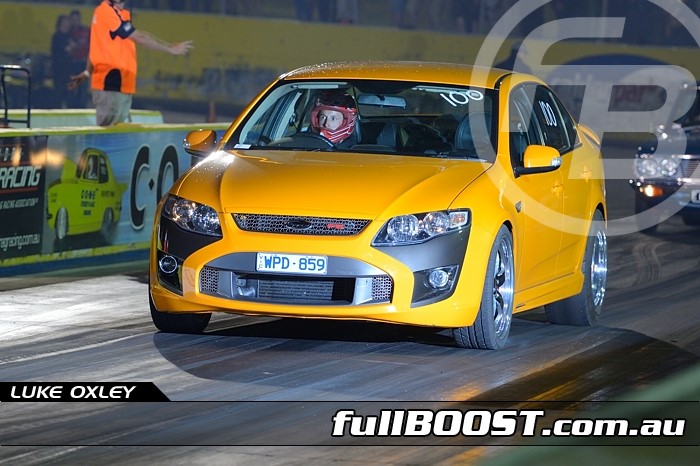

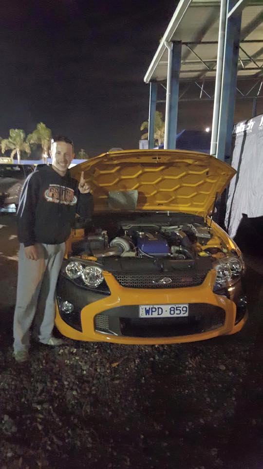

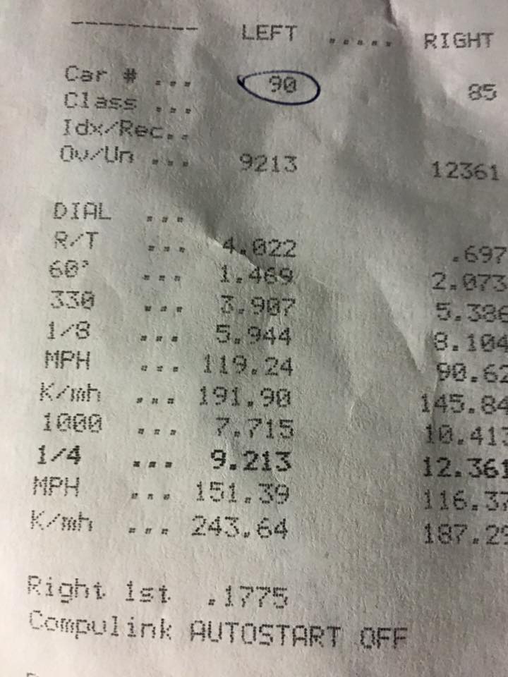

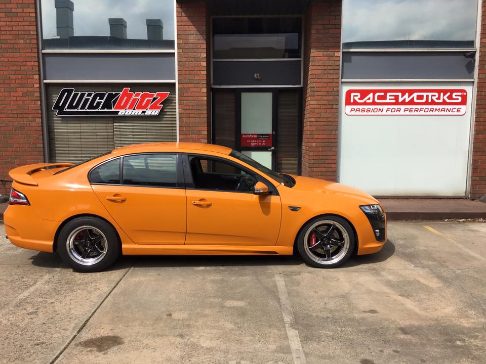

FG310 Member 51 Member For: 15y 9m 25d Posted 06/11/15 07:01 AM Author Share Posted 06/11/15 07:01 AM Freshened up the engine, new turbo gtx4202r, fuel system car made 650rwkw on 34psi. Went 9.21 151mph on a radial tire drove to the track and home, makes it officially the fastest fg street car in the country with a ZF 6speed too.. Me and my best mate (QUICKBITZ) freshened up the motor, nizpro still do all the tuning and zf side of things.. Thanks to NIZPRO QUICKBITZDan Otway for the Circle D Converter 5 Link to comment https://www.fordxr6turbo.com/forum/topic/85301-fg-f6-547rwkw/page/8/#findComment-1568588 Share on other sites More sharing options...

FG310 Member 51 Member For: 15y 9m 25d Posted 06/11/15 01:39 PM Author Share Posted 06/11/15 01:39 PM Didn't bother to get a dyno sheet not really fussed, engines showing close to 1200hp to run the mph at the weight.. Tire is a 275/50/17 m&h radial Link to comment https://www.fordxr6turbo.com/forum/topic/85301-fg-f6-547rwkw/page/8/#findComment-1568669 Share on other sites More sharing options...
PTR_NITRO_FG Donating Members 3,214 Member For: 12y 22d Gender: Male Location: NOR Perth Posted 06/11/15 02:25 PM Share Posted 06/11/15 02:25 PM What rims are on the front? Are they the Crossfire D-Spec in 18x9.5+25? Link to comment https://www.fordxr6turbo.com/forum/topic/85301-fg-f6-547rwkw/page/8/#findComment-1568672 Share on other sites More sharing options...
JETURBO ...JD TUNING ADELAIDE... Gold Donating Members 23,708 Member For: 17y 16d Gender: Male Location: Adelaide Posted 06/11/15 08:47 PM Share Posted 06/11/15 08:47 PM (edited) 650/1200/151 don't stack up 151mph should be well over the ~ 700rwkw mark 1200fwhp should show ~ 724rwkw with a 19% lossYour making heaps more than 650rwkw but good results all the same. How high is the circle D going on the line and what boost are you leaving at ?Stock zf diff gears still ? Edited 06/11/15 08:48 PM by Womend Bellbat Link to comment https://www.fordxr6turbo.com/forum/topic/85301-fg-f6-547rwkw/page/8/#findComment-1568680 Share on other sites More sharing options...
