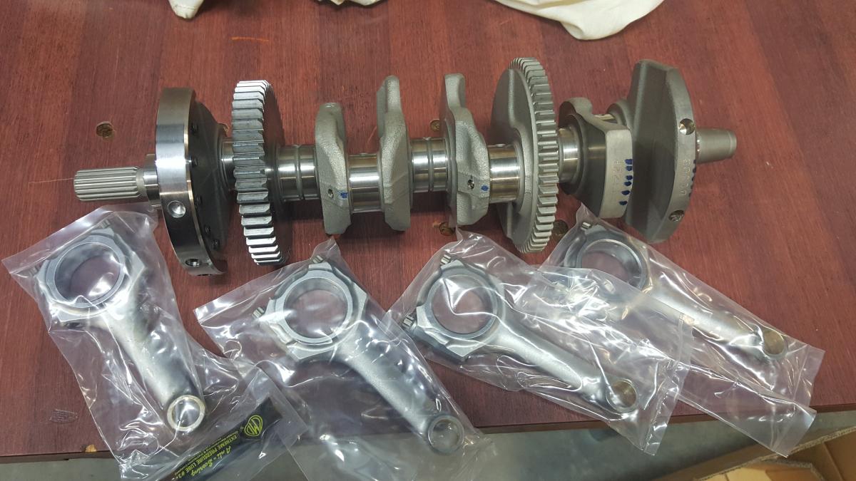

Boganspeed Will do skids for food Silver Donating Members 1,177 Member For: 13y 7m 13d Gender: Male Location: Perth SOR Posted 15/07/15 02:05 PM Share Posted 15/07/15 02:05 PM (edited) So my brand new genuine crankshaft arrived yesterday.This is for a K8 which has better oiling to the mains than the original crank and just needs a couple of mods to the slip on timing gear to match the different splines.I'd love to have it lightened, knife edged and have the balancer drive gear machined off but time and budget arent letting me.I ordered a heavy duty Robinson output shaft from Schnitz Racing today.Once that arrives, the bottom end can go together.Pic shows the Falicon rods that lobbed a little while back.They are so well made that at first I couldnt see the split around the sides where the mains cap comes off. They will be spot on for my HP needs. Edited 15/07/15 02:10 PM by Boganspeed 1 Link to comment https://www.fordxr6turbo.com/forum/topic/84870-2-wheel-transport/page/32/#findComment-1554020 Share on other sites More sharing options...
arronm Dropping a turd Gold Donating Members 9,520 Member For: 17y 7m 22d Gender: Male Location: Perth Posted 16/07/15 02:11 AM Share Posted 16/07/15 02:11 AM Yeh. No split like gsx rods. Can't beat the roller bearing bottom end 1 Link to comment https://www.fordxr6turbo.com/forum/topic/84870-2-wheel-transport/page/32/#findComment-1554071 Share on other sites More sharing options...
