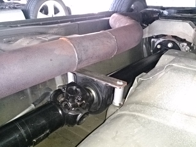

CHLAXN Donating Members 932 Member For: 17y 17d Gender: Male Location: north QLD Posted 05/10/13 09:51 PM Share Posted 05/10/13 09:51 PM Here is a pic of mine in the ute. Was lucky that it has no vibrations or noises. Hardy spicer in Mackay did mine. Link to comment https://www.fordxr6turbo.com/forum/topic/84682-upgraded-tailshaft-vibration/page/6/#findComment-1430727 Share on other sites More sharing options...
wilba Member 828 Member For: 16y 7m 6d Gender: Male Posted 06/10/13 07:55 AM Share Posted 06/10/13 07:55 AM So your center barring isn't even spaced! By the look of the pic. I really dnt no what to do my is spaced that The shaft is just about straight from gear box to diff. at a guess about 50mm Link to comment https://www.fordxr6turbo.com/forum/topic/84682-upgraded-tailshaft-vibration/page/6/#findComment-1430828 Share on other sites More sharing options...

wilba Member 828 Member For: 16y 7m 6d Gender: Male Posted 06/10/13 09:35 PM Share Posted 06/10/13 09:35 PM What sort of centre barring is that? On 05/10/2013 at 9:51 PM, CHLAXN said: Here is a pic of mine in the ute. Was lucky that it has no vibrations or noises. Hardy spicer in Mackay did mine. On 05/10/2013 at 9:51 PM, CHLAXN said: Here is a pic of mine in the ute. Was lucky that it has no vibrations or noises. Hardy spicer in Mackay did mine. Link to comment https://www.fordxr6turbo.com/forum/topic/84682-upgraded-tailshaft-vibration/page/6/#findComment-1430905 Share on other sites More sharing options...
CHLAXN Donating Members 932 Member For: 17y 17d Gender: Male Location: north QLD Posted 06/10/13 10:16 PM Share Posted 06/10/13 10:16 PM Stock center bearing mate. Guys at hardy spicer said too see how it goes with the stock one as you don't have to space it. If it's no good they will put a bigger one in but need the car as it will have to be spaced like yours is. So far it's holding up. Link to comment https://www.fordxr6turbo.com/forum/topic/84682-upgraded-tailshaft-vibration/page/6/#findComment-1430911 Share on other sites More sharing options...
wilba Member 828 Member For: 16y 7m 6d Gender: Male Posted 06/10/13 10:43 PM Share Posted 06/10/13 10:43 PM To easy.I might try that Link to comment https://www.fordxr6turbo.com/forum/topic/84682-upgraded-tailshaft-vibration/page/6/#findComment-1430912 Share on other sites More sharing options...
