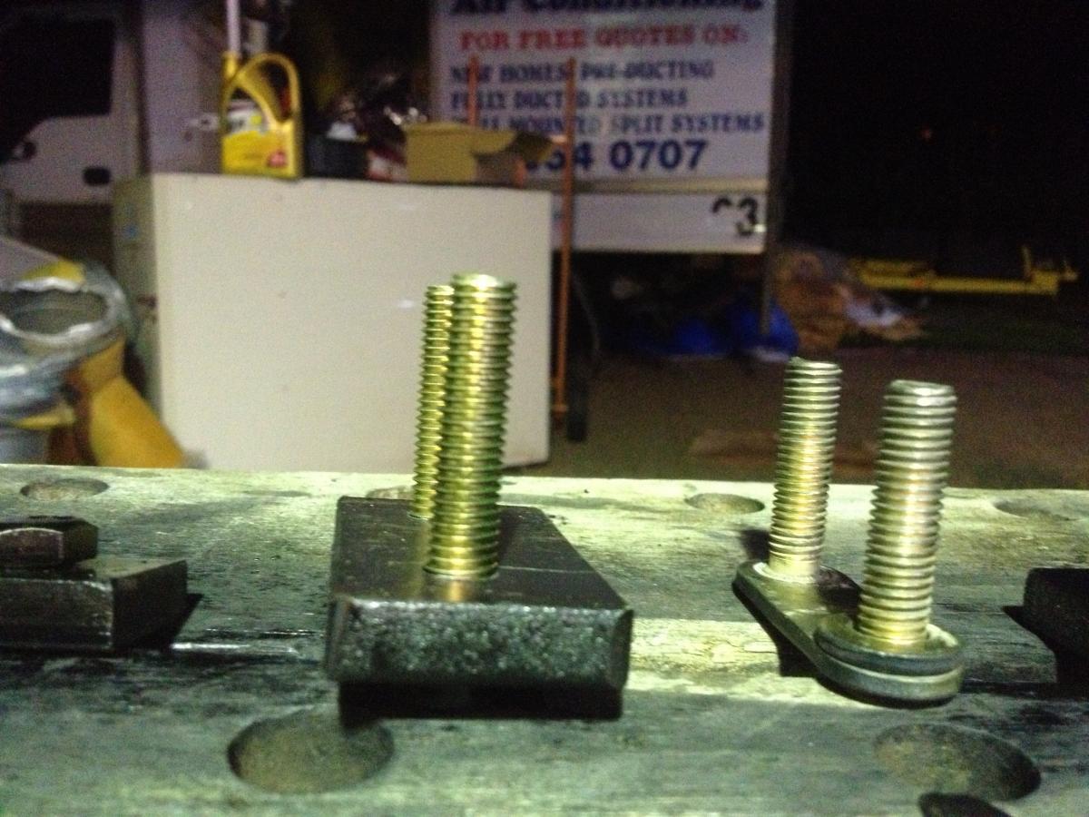

spinr33 Donating Members 964 Member For: 13y 10m 1d Posted 09/04/13 11:14 AM Share Posted 09/04/13 11:14 AM (edited) That looks like a pretty cheap and nasty thing the bolts being threaded the whole way weaken the bolt.A piece of plate some new high tensile bolts afew holes bolts welded at head no problems it looks like you could go bigger bolts if you redrill everything may be worth while if you do motorsport also lock nuts those supplied nuts don't look much chop even with the spring washer Edited 09/04/13 11:15 AM by spinr33 Link to comment https://www.fordxr6turbo.com/forum/topic/84537-ripped-out-upper-control-arm-ba-ute/page/2/#findComment-1379097 Share on other sites More sharing options...
Smoke them tyres Member 557 Member For: 17y 5m 28d Gender: Male Location: Brisbane Posted 26/04/13 11:10 PM Share Posted 26/04/13 11:10 PM A pic of the END of the broken bolt would be better. If it has "beach" marks of a gradual failure, or no beach marks of a sudden failure, will tell the story.The bolt plate may be more convenient, but there is a tendency in the industry to use "adequate" bolts in these positions....and then say installation is "easy". I would use at least a grade 8 bolt.Suspension and brake breakages/failures should be viewed with scorn as they are a direct car control issue. Link to comment https://www.fordxr6turbo.com/forum/topic/84537-ripped-out-upper-control-arm-ba-ute/page/2/#findComment-1384203 Share on other sites More sharing options...

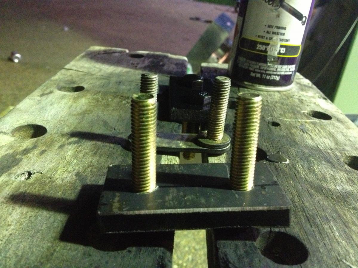

P_BA_XR6 Member 271 Member For: 17y 17d Gender: Male Location: Castle Hill Posted 01/05/13 12:22 AM Author Share Posted 01/05/13 12:22 AM Made my own version, I have gut feeling this should last 1 Link to comment https://www.fordxr6turbo.com/forum/topic/84537-ripped-out-upper-control-arm-ba-ute/page/2/#findComment-1385300 Share on other sites More sharing options...
senna_T Forged Member Lifetime Members 15,818 Member For: 18y 4m 11d Gender: Male Location: SW Sydney Posted 01/05/13 03:09 AM Share Posted 01/05/13 03:09 AM Just check to see if that plate will fit flush against the strut tower - there are some bends and seam lines on the inside where that is going to sit. If it is not flush there is a good chance the bolts will elongate the holes in the tower... Link to comment https://www.fordxr6turbo.com/forum/topic/84537-ripped-out-upper-control-arm-ba-ute/page/2/#findComment-1385356 Share on other sites More sharing options...
Kroozin Menace Donating Members 1,990 Member For: 14y 1m 28d Gender: Male Location: Sydney Posted 01/05/13 03:13 AM Share Posted 01/05/13 03:13 AM Yeh we fitted in some spacers, roughly 3-4mm from memory. cheers bud.Might explain why the others f'd up too Link to comment https://www.fordxr6turbo.com/forum/topic/84537-ripped-out-upper-control-arm-ba-ute/page/2/#findComment-1385359 Share on other sites More sharing options...
P_BA_XR6 Member 271 Member For: 17y 17d Gender: Male Location: Castle Hill Posted 01/05/13 05:08 AM Author Share Posted 01/05/13 05:08 AM As kroozin said fitted spacers to match the step Link to comment https://www.fordxr6turbo.com/forum/topic/84537-ripped-out-upper-control-arm-ba-ute/page/2/#findComment-1385392 Share on other sites More sharing options...
senna_T Forged Member Lifetime Members 15,818 Member For: 18y 4m 11d Gender: Male Location: SW Sydney Posted 01/05/13 06:39 AM Share Posted 01/05/13 06:39 AM Nice one Link to comment https://www.fordxr6turbo.com/forum/topic/84537-ripped-out-upper-control-arm-ba-ute/page/2/#findComment-1385411 Share on other sites More sharing options...
