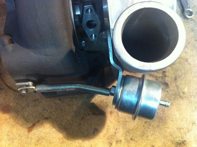

usernumber1234 Member 47 Member For: 13y 2m 24d Posted 07/04/13 03:07 AM Share Posted 07/04/13 03:07 AM How much movement should I be be getting from the flapper? Like at the furthest part from the axle where it opens how much are we talking in mm's?Changed actuators and it doesnt look right Link to comment https://www.fordxr6turbo.com/forum/topic/84533-actuator-movement/ Share on other sites More sharing options...
JETURBO ...JD TUNING ADELAIDE... Gold Donating Members 23,708 Member For: 16y 11m 16d Gender: Male Location: Adelaide Posted 07/04/13 04:56 AM Share Posted 07/04/13 04:56 AM Actuator has approx 30mm movement Link to comment https://www.fordxr6turbo.com/forum/topic/84533-actuator-movement/#findComment-1378218 Share on other sites More sharing options...
Ralph Wiggum Moar Powar Babeh Lifetime Members 19,332 Member For: 19y 7m 24d Gender: Male Location: Perth Posted 07/04/13 06:32 AM Share Posted 07/04/13 06:32 AM How much preload do you have on the gate? Excess preload shortens the travel. Link to comment https://www.fordxr6turbo.com/forum/topic/84533-actuator-movement/#findComment-1378231 Share on other sites More sharing options...
usernumber1234 Member 47 Member For: 13y 2m 24d Posted 07/04/13 06:59 AM Author Share Posted 07/04/13 06:59 AM Yeah how much preload is needed? That may be my issue. Probs getting 20mm max. If I go one more turn the flapper will be able to spin. Link to comment https://www.fordxr6turbo.com/forum/topic/84533-actuator-movement/#findComment-1378239 Share on other sites More sharing options...
JETURBO ...JD TUNING ADELAIDE... Gold Donating Members 23,708 Member For: 16y 11m 16d Gender: Male Location: Adelaide Posted 07/04/13 07:01 AM Share Posted 07/04/13 07:01 AM Two turns from base which iirc makes it 1/2 hole pre load Link to comment https://www.fordxr6turbo.com/forum/topic/84533-actuator-movement/#findComment-1378242 Share on other sites More sharing options...
usernumber1234 Member 47 Member For: 13y 2m 24d Posted 07/04/13 07:03 AM Author Share Posted 07/04/13 07:03 AM Next question. Running a standard exhaust housing with a .70 compressor housing so standard actuator bracket doesnt fit. Made my own one but I think that may be the issue. Best place to get a proper actuator bracket? Link to comment https://www.fordxr6turbo.com/forum/topic/84533-actuator-movement/#findComment-1378244 Share on other sites More sharing options...
JETURBO ...JD TUNING ADELAIDE... Gold Donating Members 23,708 Member For: 16y 11m 16d Gender: Male Location: Adelaide Posted 07/04/13 07:03 AM Share Posted 07/04/13 07:03 AM MTQ Link to comment https://www.fordxr6turbo.com/forum/topic/84533-actuator-movement/#findComment-1378245 Share on other sites More sharing options...

The Converted Donating Members 344 Member For: 13y 8m 11d Gender: Male Location: Melbourne Posted 07/04/13 08:55 PM Share Posted 07/04/13 08:55 PM May need to bend it a little. Link to comment https://www.fordxr6turbo.com/forum/topic/84533-actuator-movement/#findComment-1378350 Share on other sites More sharing options...
