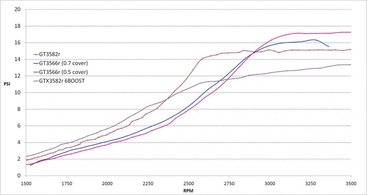

IH8TOADS Silver Donating Members 3,618 Member For: 19y 9m 16d Gender: Male Location: OZ Posted 24/07/13 11:40 AM Share Posted 24/07/13 11:40 AM Data doesn't lie and didn't I just get a surprise. Went out and did a 4th gear spool log of the new set-up. The Turbo is so quiet I was expecting it to spool slower than the GT3566r......boy was I wrong.Its out-spooling the stock manifold and GT3582r (0.5 cover) and has 2psi on the GT3566r as it ramps up. STOKED.The minimum boost is 5.5psi (7psi rated spring) and the gate is opening well before the eBoost gate pressure so I desperately need to put a much heavier spring and feed so boost to the top of the gate. At 80% duty I'm only seeing 14psi....and more duty cycle isn't doing much. Link to comment https://www.fordxr6turbo.com/forum/topic/84024-gtx3582r-with-6boost-manifold/page/8/#findComment-1409643 Share on other sites More sharing options...
