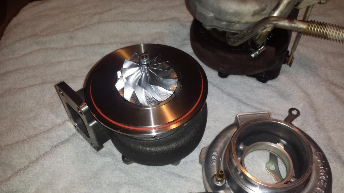

Stigmata Donating Members 235 Member For: 12y 1m 21d Gender: Male Posted 14/09/13 11:15 AM Author Share Posted 14/09/13 11:15 AM Hi Everyone, my apologies for not being online much of late. I have finally started the work on my G6 with today spent measuring the front for the new cooler, its a light weight tube and fin from Europe. Its going to be a tight fit compared with the PWR stepped unit. I removed the OEM 76 and have the GTX 76 ready to bolt on in the morning Hopefully I should have all the work/mods done in a few weeks. Here are some pics from today. I hope everyone is well. Will post more pics as the progress continuesKind regards Jon Link to comment Share on other sites More sharing options...

wagnman Member 567 Member For: 15y 8m 13d Posted 16/09/13 04:26 AM Share Posted 16/09/13 04:26 AM Ingesting turbo you have gone for. Is it the same size as the std g6 one but better flowing/bearings/wastegate etc etc? Will this out perform the std one above the usual 5000rpm drop off point? Cheers Link to comment Share on other sites More sharing options...
Bellato Donating Members 2,713 Member For: 14y 4m 15d Posted 16/09/13 05:03 AM Share Posted 16/09/13 05:03 AM From what I've read gtx3576 is good for about 380rwkw on 98 and over 400 on the corn juice. Still got that punch down low but gives it a bit more up top over its little brotherNice build Link to comment Share on other sites More sharing options...

Stigmata Donating Members 235 Member For: 12y 1m 21d Gender: Male Posted 16/09/13 10:10 AM Author Share Posted 16/09/13 10:10 AM Hey guys, well I fitted the o ring tonight and bolted the 4" dump on. That damn o ring! lol. Ford has been using that idea for a long time hey!Yeah I was tossing between the 82 and 76 but went the 76 path. I love the quick spool. Making the transition to E85 at same time as all this too. Would really like to see 400rwkw from the little snail on the alcohol. Would be real happy to run a 10.999999et with the 76 before I go the high mount route later down the track. Will push it until I do LOL. Hopefully will finish bolting the exhaust up after work this week and will start fabbing the driver side intake. Going to run an intank 400lph Walbro with modded basket, hopefully should be all good. Will find out if it throws a leg and piston from massive lean out! lamo Will post some more pics later in week once I have done some more. I hope everyone is well . That new cooler will be some work, not much room for something that big. Anyway, will update the build again soonKind regards Jon Link to comment Share on other sites More sharing options...
