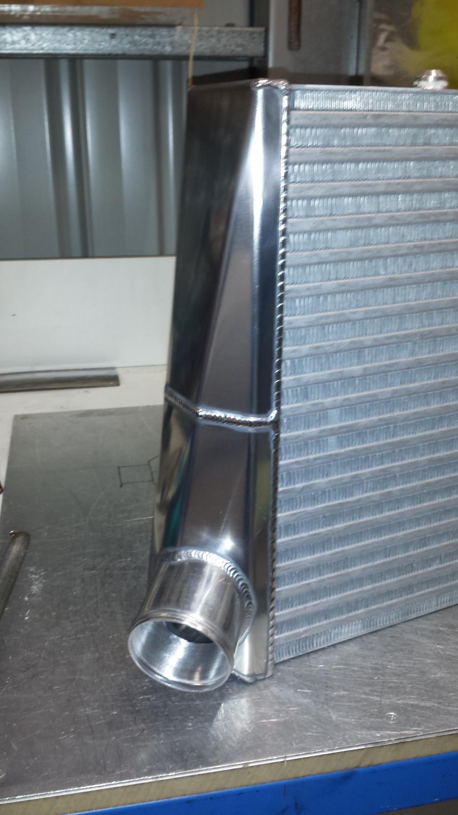

jimmixr Donating Members 686 Member For: 14y 9m 28d Posted 18/06/14 11:37 AM Share Posted 18/06/14 11:37 AM Holly Jesus that core IS huge!!!This is going to be a huge watch for me !!those headers are a work of art.. seriously..Oh..and you need a wheel alignment.. badly lol Link to comment https://www.fordxr6turbo.com/forum/topic/83988-g6et-first-tune/page/20/#findComment-1479381 Share on other sites More sharing options...
MattyP MattyP Cruise Control 6,317 Member For: 13y 1m 12d Gender: Male Location: Central Coast Posted 18/06/14 11:40 AM Share Posted 18/06/14 11:40 AM Wow jon Good luck with that Makes my one look tinyBut as my lady says, it's not the size that counts it's how you use it 1 Link to comment https://www.fordxr6turbo.com/forum/topic/83988-g6et-first-tune/page/20/#findComment-1479383 Share on other sites More sharing options...

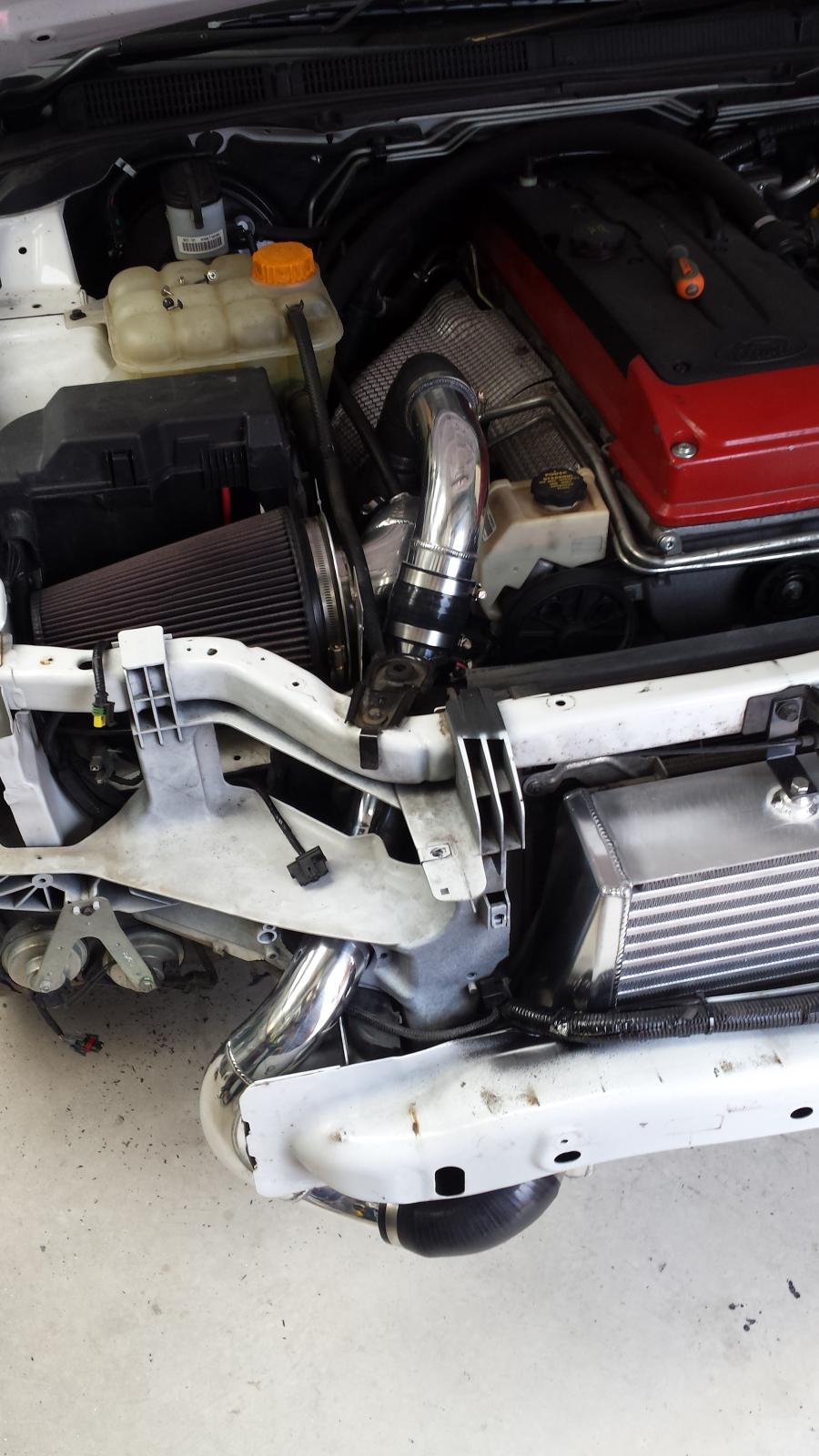

Stigmata Donating Members 235 Member For: 12y 5m 3d Gender: Male Posted 23/06/14 12:17 PM Author Share Posted 23/06/14 12:17 PM Hey GuysThe cooler is finished and bolted in. Wow what a tight fit!!! Bit harder with tube n fin as the header plate/ tanks are1 1 inch wider than the 4 inch core. This makes it rather hard as the front intrusion bar tapers back in on edges making it even tighter. The radiator had to be spaced back 35mm with some customizing of lower supports. Overall I'm pretty happy with the fit-up. I finished new hot side piping today in 2.5" and will fab the 3" cold side tomorrow. It was shocking weather to push car outside n take some pics but here's a couple showing the new setup. Will post more in next few days.Speak soon kindest regards Jon 4 Link to comment https://www.fordxr6turbo.com/forum/topic/83988-g6et-first-tune/page/20/#findComment-1480506 Share on other sites More sharing options...
Bizkets is Drunk? Too heavy needs boost Member 5,929 Member For: 11y 10m 10d Gender: Male Location: Adelaide Posted 23/06/14 01:10 PM Share Posted 23/06/14 01:10 PM end result looks the goods man. thumbs up. Would like to see the intake temps and how it rolls up and what power you can get out of it. maybe a few back to back runs. 1 Link to comment https://www.fordxr6turbo.com/forum/topic/83988-g6et-first-tune/page/20/#findComment-1480526 Share on other sites More sharing options...
BenDoCo I'm getten too old for this s**t Bronze Donating Members 4,509 Member For: 12y 2m 9d Gender: Male Location: A big bridge over a river in South Australia Posted 23/06/14 01:48 PM Share Posted 23/06/14 01:48 PM Might have to bring my car down and get you to do some welding on it for me Jon coz that's very impressiveThinking that I want the right hand tip of my Nizzy cut shorter to match what had to be done with the left one to make it fit.Hope you & the family are all doing OK mate. 1 Link to comment https://www.fordxr6turbo.com/forum/topic/83988-g6et-first-tune/page/20/#findComment-1480535 Share on other sites More sharing options...

MattyP MattyP Cruise Control 6,317 Member For: 13y 1m 12d Gender: Male Location: Central Coast Posted 23/06/14 08:00 PM Share Posted 23/06/14 08:00 PM You painting it black or leaving it polished jon?As always great work 1 Link to comment https://www.fordxr6turbo.com/forum/topic/83988-g6et-first-tune/page/20/#findComment-1480545 Share on other sites More sharing options...
