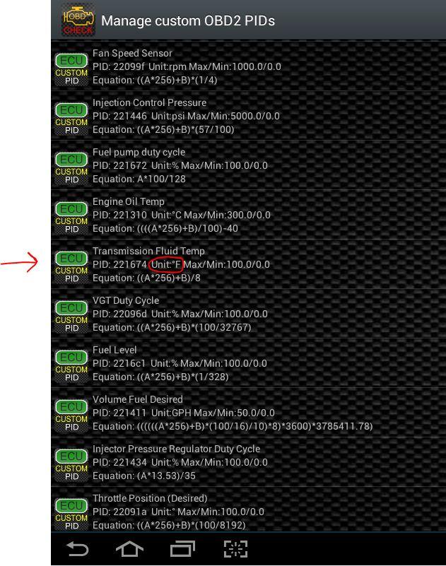

spook Donating Members 180 Member For: 17y 12d Gender: Male Posted 15/02/13 05:24 AM Share Posted 15/02/13 05:24 AM (edited) On 14/02/2013 at 11:45 AM, mrxd said: I'm still not sure that pid 221674 is trans temp, at least not on an FG. Reading seems too high.I'll double check my settings Edited 15/02/13 05:29 AM by spook Link to comment https://www.fordxr6turbo.com/forum/topic/83743-montoring-trans-temp-with-iphone/page/11/#findComment-1363102 Share on other sites More sharing options...
JETURBO ...JD TUNING ADELAIDE... Gold Donating Members 23,708 Member For: 16y 10m 16d Gender: Male Location: Adelaide Posted 15/02/13 05:26 AM Share Posted 15/02/13 05:26 AM good work spook Link to comment https://www.fordxr6turbo.com/forum/topic/83743-montoring-trans-temp-with-iphone/page/11/#findComment-1363103 Share on other sites More sharing options...
spook Donating Members 180 Member For: 17y 12d Gender: Male Posted 15/02/13 05:44 AM Share Posted 15/02/13 05:44 AM Hmmm, I think I have provided the wrong info earlier in this thread (apologies)I'm using Transmision Temperature(Method 1) and not Transmission Fluid Temp (PID 221674) as first thought.The attached pic shows some of the active sensors (in green) Torque is able to pick up. Notice the trans temp and it's value - taken 2 mins ago from my BF.Hope that helps clear up some of the confusion. Link to comment https://www.fordxr6turbo.com/forum/topic/83743-montoring-trans-temp-with-iphone/page/11/#findComment-1363111 Share on other sites More sharing options...
mrxd Member 74 Member For: 12y 6m 7d Gender: Male Posted 15/02/13 07:28 AM Share Posted 15/02/13 07:28 AM Cheers for the help spook. Method #1 gives me -40C something different between BF and FG protocols. Link to comment https://www.fordxr6turbo.com/forum/topic/83743-montoring-trans-temp-with-iphone/page/11/#findComment-1363143 Share on other sites More sharing options...
spook Donating Members 180 Member For: 17y 12d Gender: Male Posted 15/02/13 08:14 AM Share Posted 15/02/13 08:14 AM Let me know if the reading you are getting using 221674 is in Fahrenheit Link to comment https://www.fordxr6turbo.com/forum/topic/83743-montoring-trans-temp-with-iphone/page/11/#findComment-1363159 Share on other sites More sharing options...
mrxd Member 74 Member For: 12y 6m 7d Gender: Male Posted 15/02/13 08:30 AM Share Posted 15/02/13 08:30 AM Its dependent on what I set "units" too in the torque settings. If I have it set to Fahrenheit I get 365F, if I set it to Celsius I get 185C. So the conversion is right. Just the value seems high. If it were 185F that would make more sense. Link to comment https://www.fordxr6turbo.com/forum/topic/83743-montoring-trans-temp-with-iphone/page/11/#findComment-1363163 Share on other sites More sharing options...
