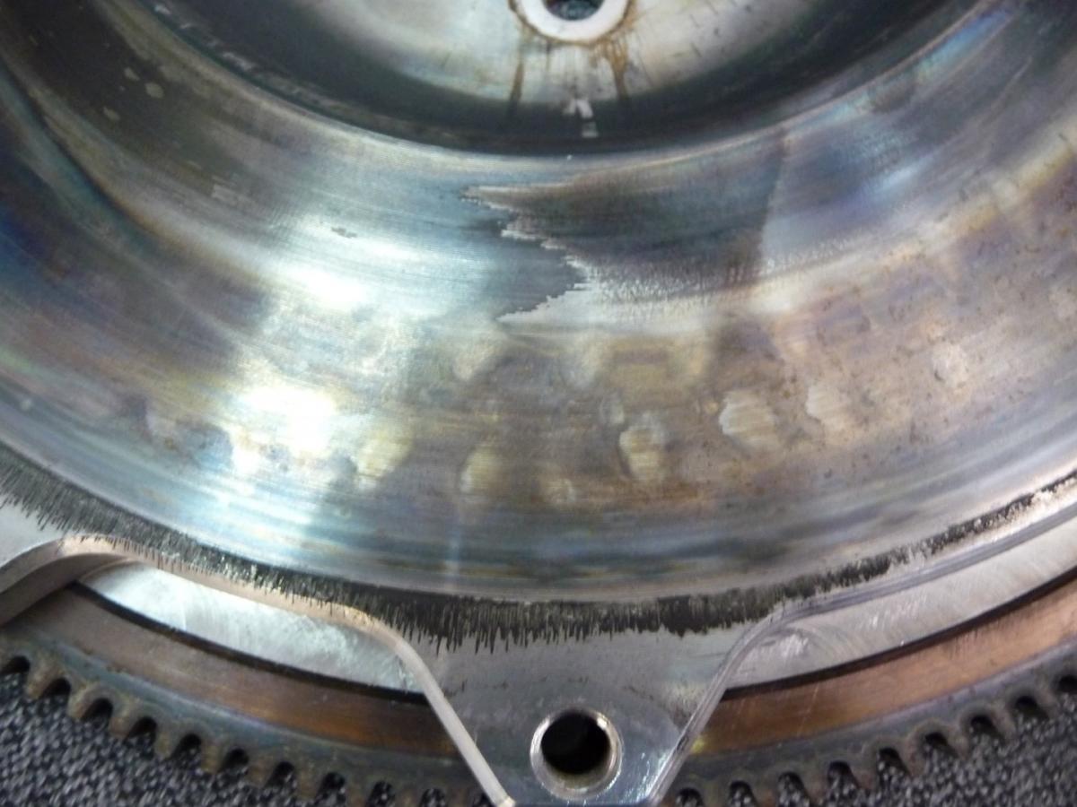

FPVFGS Member 359 Member For: 13y 1m 20d Gender: Male Location: Mornington Posted 03/02/13 04:20 AM Share Posted 03/02/13 04:20 AM On 03/02/2013 at 2:10 AM, Rollin said: Rollin the point is that you only have 315rwkw. Why have you even got the opt5? Going by the ratings an opt3+ should be fine for your car.The main discussion of this thread is why are the clutch dying below there ratings,Of course your clutch is going to hold up,Its rated for over 550rwkw.Dosnt seem like we will get an answer to why as it seems everytime a clutch has been slipping no one is sending them back to Mal Wood to be diagnosed.Nice videos by the way!Would have thought the videos would be a pretty good example of why I have/need an option 5....Don't know why nobody sends the clutches back, seems like they're trying to hide something to me...but I'm naturally a suspicious type of preson though.Something as inconsequential as finger print oil on the flywheel can have a marked effect on the power handling capabilities of a clutch - a lot of people (even mechanics, ffs, used to do my head in) reckon that oils etc will 'burn off' in service, but it doesn't. It burns INTO the flywheel and glazes it, which wrecks any power handling capability the clutch would otherwise have.The flywheel, pressure plate and friction disc/s must be surgically clean before assembly - only perfectly clean hands, fresh super clean rags, copious amounts of 'brake clean' (which evaporates without leaving any residue) and compressed air must be used.I don't expect any of you gents with shiny new cars would have to worry about oil leaks just yet, but rear main seal, sump, rocker cover or input shaft oil leaks can also affect the clutch - even if it's not dripping directly onto it, it gets pretty windy inside a bell housing at 6000rpm, and oil vapours can contaminate the clutch as well.I'm dead keen to see pics of dead clutches here - anyone got pics?Mine is coming out sometime next week. And Paul will have it back . I will take pictures and post them up no problem . And I'm happy for Paul to put is honest input in too . Link to comment https://www.fordxr6turbo.com/forum/topic/83653-clutch-recommendations/page/27/#findComment-1357869 Share on other sites More sharing options...

OED666 Member 129 Member For: 18y 11m 29d Gender: Male Location: Gold Coast, Qld Posted 06/02/13 06:36 AM Share Posted 06/02/13 06:36 AM I wasn't at work today, however Mal is going to send me the photos of the clutch. Apparently it was pretty bad! :S Link to comment https://www.fordxr6turbo.com/forum/topic/83653-clutch-recommendations/page/27/#findComment-1359366 Share on other sites More sharing options...
Trent0 The Toxic Rocket Donating Members 574 Member For: 15y 1m 28d Gender: Male Location: Brisbane Posted 06/02/13 06:42 AM Share Posted 06/02/13 06:42 AM I called him around 2 hrs ago and he said that :znot good, but should have something to send up to me tomorrow fingers crossed :D Link to comment https://www.fordxr6turbo.com/forum/topic/83653-clutch-recommendations/page/27/#findComment-1359368 Share on other sites More sharing options...

OED666 Member 129 Member For: 18y 11m 29d Gender: Male Location: Gold Coast, Qld Posted 06/02/13 07:34 AM Share Posted 06/02/13 07:34 AM Here are the photos of Trent's clutch...As you can see on the flywheel near the ring gear there is a build up of grease/oil on the outside, and the contamination had made its way through the clutch plate. Pictures speak a thousand words! 1 Link to comment https://www.fordxr6turbo.com/forum/topic/83653-clutch-recommendations/page/27/#findComment-1359393 Share on other sites More sharing options...
