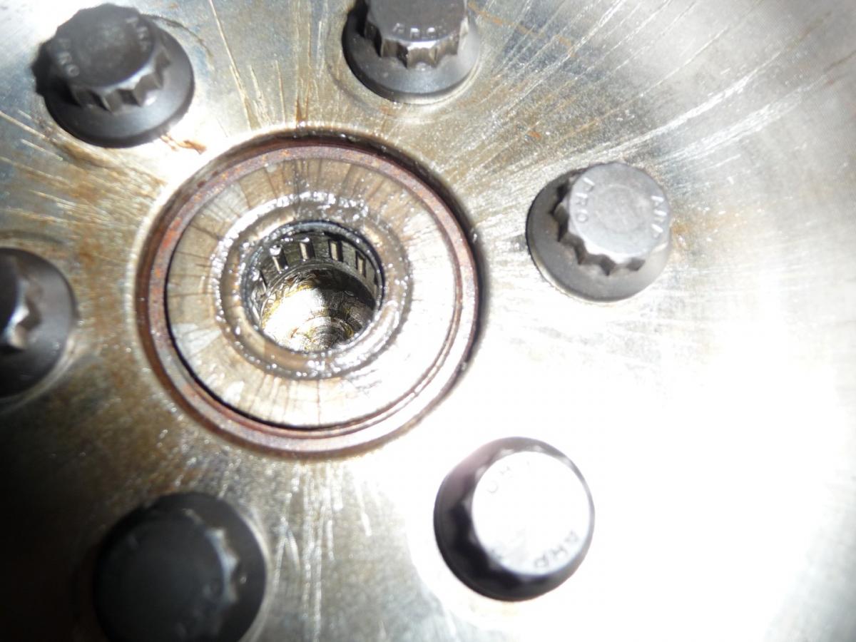

OED666 Member 129 Member For: 18y 9m 21d Gender: Male Location: Gold Coast, Qld Posted 23/01/13 12:57 AM Share Posted 23/01/13 12:57 AM (edited) Attached is a photo of the goodness coming out of a factory spigot bearing. This clutch plate had grease on the flywheel side due to the spigot bearing not being replaced. Edited 23/01/13 01:06 AM by OED666 Link to comment https://www.fordxr6turbo.com/forum/topic/83653-clutch-recommendations/page/11/#findComment-1353257 Share on other sites More sharing options...

Ralph Wiggum Moar Powar Babeh Lifetime Members 19,331 Member For: 19y 6m 22d Gender: Male Location: Perth Posted 23/01/13 01:06 AM Share Posted 23/01/13 01:06 AM On 23/01/2013 at 12:57 AM, OED666 said: Attached is a photo of the goodness coming out of a factory spigot bearing. This clutch plate had grease on the flywheel side due to the spigot bearing not being replaced. Got any pics of the damage a dodgy stock spigot bearing does to the input shaft? Link to comment https://www.fordxr6turbo.com/forum/topic/83653-clutch-recommendations/page/11/#findComment-1353266 Share on other sites More sharing options...
