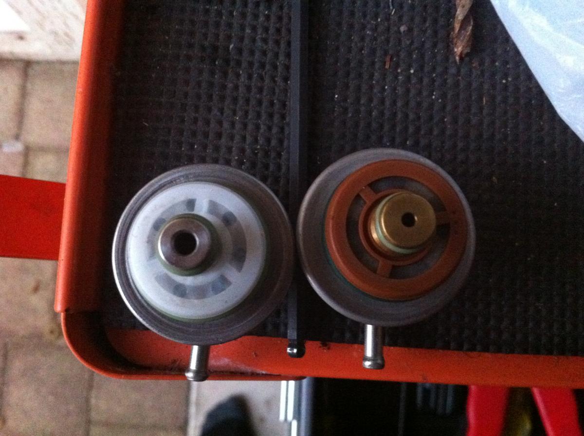

IH8TOADS Silver Donating Members 3,618 Member For: 19y 9m 8d Gender: Male Location: OZ Posted 14/01/13 11:04 AM Share Posted 14/01/13 11:04 AM (edited) A lot of talk about fuel systems of late and since I have been asked about regs a few times I thought I would post an option for a OEM location reg replacement.Attachment shows aftermarket vs Stock Bosch......wonder why your pressure backs up. The stock return is tiny, can only help to go bigger!http://www.034motorsport.com/fuel-injection-solutions-fuel-pressure-regulators-fuel-pressure-regulator-drop-in-35-45-bar-p-19082.htmlI've used two 4.0 bar and one 4.5 bar (all blueprinted) and they all have performed well, had a few tanks of e85 go through also (they state e85 compatible).Have I physically measured gauge pressure difference......unfortunately not, but these are a good option for those with a walbro and/or single 044. Any more/bigger pumps and a FPR1200 size reg / aftermarket lines / rail would be warranted (I have no data to support this though.....). Edited 14/01/13 11:06 AM by IH8TOADS Link to comment https://www.fordxr6turbo.com/forum/topic/83577-fuel-pressure-regulator-aftermarket-for-oem-rail/ Share on other sites More sharing options...

IH8TOADS Silver Donating Members 3,618 Member For: 19y 9m 8d Gender: Male Location: OZ Posted 14/01/13 12:35 PM Author Share Posted 14/01/13 12:35 PM Yeah drill bit. I'd rather something with a bit more precision than hacking at it though! I like the fact they blueprint them.If you look closely you'll notice I'm wearing socks too...in my garage. Burn away lol!Nah no spares wiggy, got some factory ones though. Link to comment https://www.fordxr6turbo.com/forum/topic/83577-fuel-pressure-regulator-aftermarket-for-oem-rail/#findComment-1349432 Share on other sites More sharing options...
