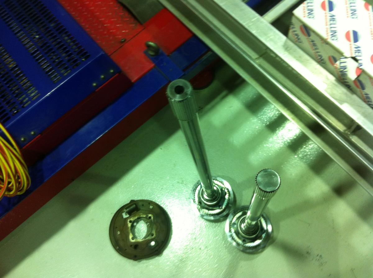

relentless xr6 Member 363 Member For: 14y 5m 4d Gender: Male Location: Sydney Posted 12/11/12 02:49 AM Author Share Posted 12/11/12 02:49 AM well I guess I better clear things up my falcon was previously a na which was passed down to me which I converted to turbo and has been good to me for the past 2 years. yes the easier option is to buy a cortina or capri but im young and I like modern cars so that's why im building the falcon into a race car, I have been in the drag racing seen for about 7 years and not once have I seen a turbo car do well I agree turbos are awesome to watch but for bracket racing the v8s are going to dominate. my 9 inch consists of a custom made housing, full spool, custom made axles and custom tonewheel for the sensors to pick up on. Link to comment https://www.fordxr6turbo.com/forum/topic/82796-building-a-race-car/#findComment-1323890 Share on other sites More sharing options...

relentless xr6 Member 363 Member For: 14y 5m 4d Gender: Male Location: Sydney Posted 12/11/12 03:42 AM Author Share Posted 12/11/12 03:42 AM groverider engineering done the housing I built the centre and took the measurements and sent them to strange engineering to make the custom axles to fit the tonewheel for the sensor. Link to comment https://www.fordxr6turbo.com/forum/topic/82796-building-a-race-car/#findComment-1323917 Share on other sites More sharing options...

relentless xr6 Member 363 Member For: 14y 5m 4d Gender: Male Location: Sydney Posted 16/11/12 07:31 AM Author Share Posted 16/11/12 07:31 AM hey guys well this thread is pointless without pictures so I thought ill put some pics of my 9 inch still running abs been working on the car for the past couple of days to fit the diff and today I finally roadtested it all I can say is wow full spools are good little bit of chatter out of driveways but other than that everything is good 1 Link to comment https://www.fordxr6turbo.com/forum/topic/82796-building-a-race-car/#findComment-1326088 Share on other sites More sharing options...
