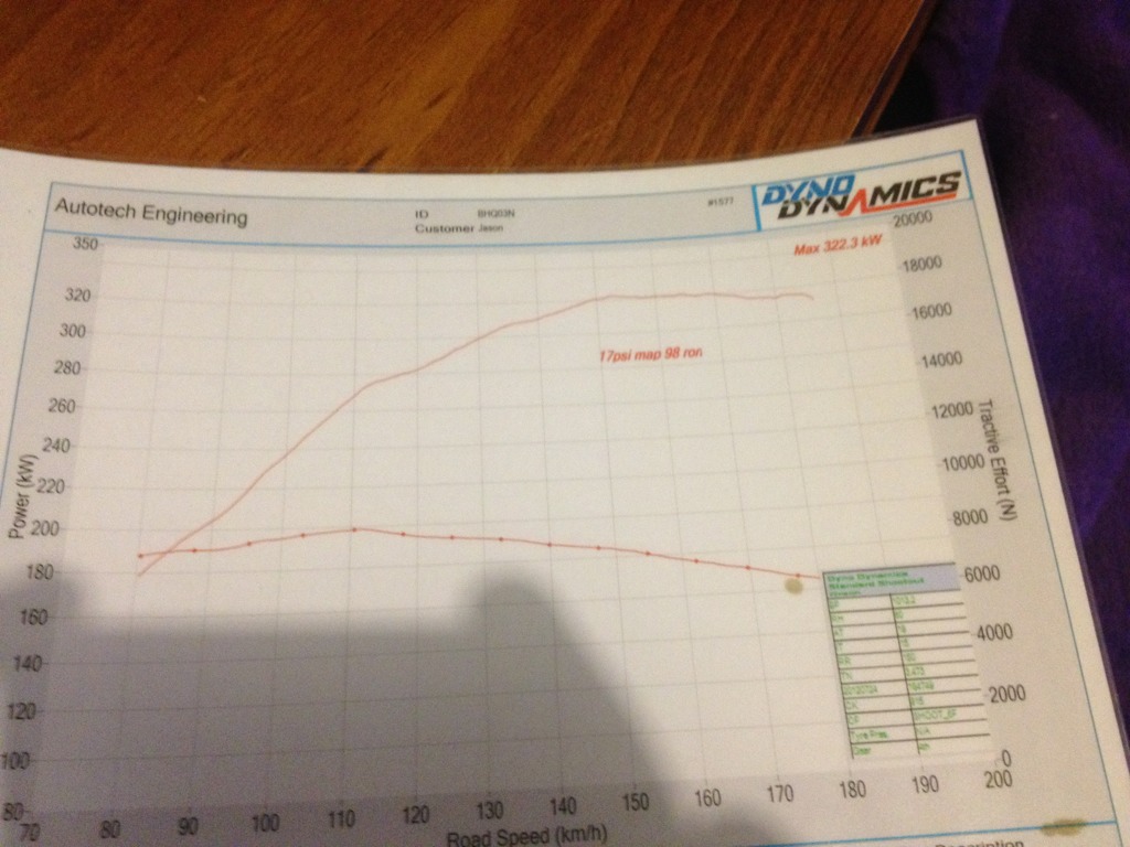

Paulie2256 Donating Members 7,441 Member For: 16y 4m 30d Gender: Male Location: SE Melbourne Posted 15/09/12 01:01 AM Share Posted 15/09/12 01:01 AM On 14/09/2012 at 11:53 PM, Kosij said: 17psi the whole way no change in boost pressure at all!do you have a dyno graph? Link to comment https://www.fordxr6turbo.com/forum/topic/81923-what-mods-or-parts-make-you-need-less-boost/page/2/#findComment-1295262 Share on other sites More sharing options...

Paulie2256 Donating Members 7,441 Member For: 16y 4m 30d Gender: Male Location: SE Melbourne Posted 15/09/12 01:45 AM Share Posted 15/09/12 01:45 AM Yeah can't see much from the graph because the wrong info is displayed. Anyway, your eboost set up and the tune is probably the factor here. May I ask why you have the eboost if you are just running a flat 17psi? 1 Link to comment https://www.fordxr6turbo.com/forum/topic/81923-what-mods-or-parts-make-you-need-less-boost/page/2/#findComment-1295285 Share on other sites More sharing options...

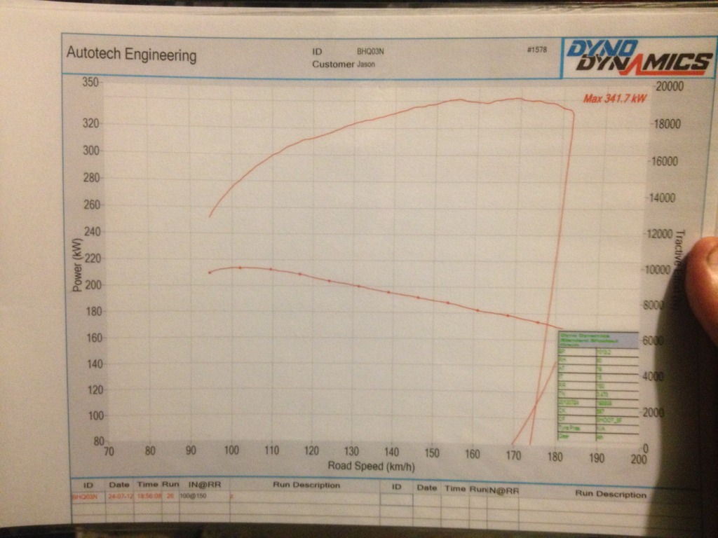

GTEXXED Banned Banned 910 Member For: 12y 9m Gender: Male Posted 15/09/12 02:03 AM Share Posted 15/09/12 02:03 AM The power curve on the e85 tune is soft as a marshmallow,my 100 E10 tune has way less area under the curve and only 16psi.Ask for the boost to be pumped in quicker mate mate,wack some semis on and enjoy:)You got a 2.5" hot side or std,the std item makes boost alot sooner and is good for 400rwkw easy,had mine on for about 2 days and went back to std hot side and she went faster everywhere. Link to comment https://www.fordxr6turbo.com/forum/topic/81923-what-mods-or-parts-make-you-need-less-boost/page/2/#findComment-1295294 Share on other sites More sharing options...
