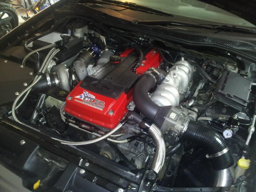

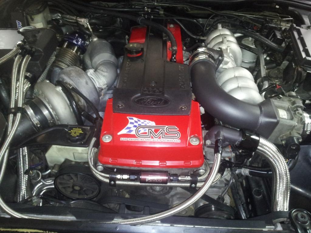

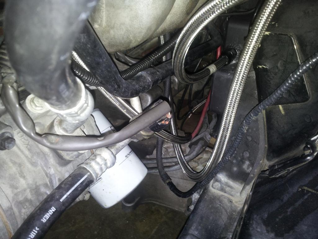

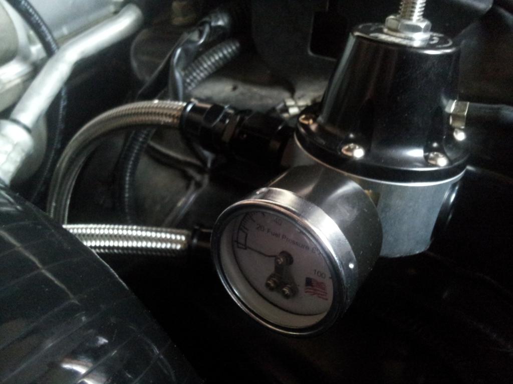

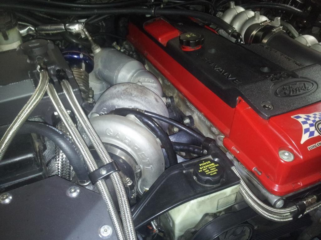

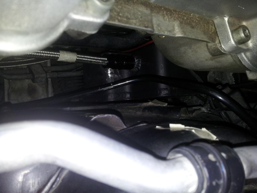

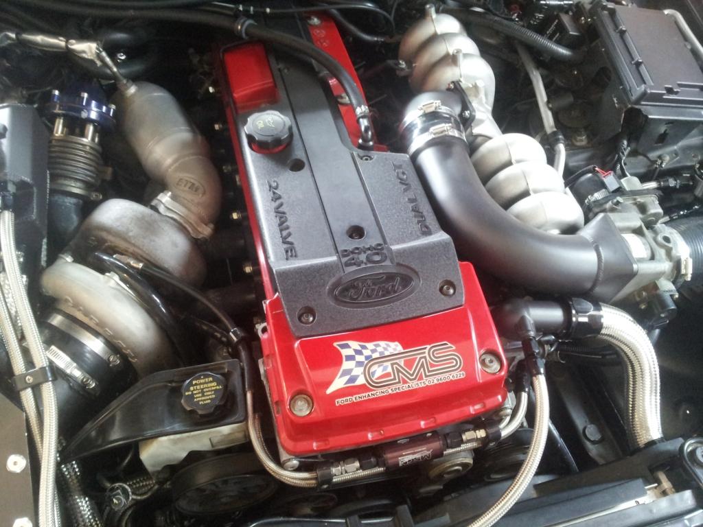

CCCC miso xr6 Donating Members 317 Member For: 16y 4m 21d Posted 02/02/13 03:33 AM Author Share Posted 02/02/13 03:33 AM Here is a few pictures of my engine bay. I have done a lot more work now. I have put basically a new fuel system in consisting of all speedflow 200 series fittings, -6 and -8 with new turbosmart fpr 2000 fuel regulator. All teflon -6 and -8 lines modified plazmaman surge tank, speed flow fuel filters, 100micron and 10 micron.Everything now is Teflon from tank to rail and I am very happy with the speedflow fittings and teflon lines as they are so easy to work with.Sourced it all from MSCN Motorsport Connections, Seven Hills.The only thing I have got left to change is the stupid Bosch 2000cc Injectors, they just keep failing for some stupid reason. I have had 2 injectors fail on me already. Link to comment https://www.fordxr6turbo.com/forum/topic/81869-my-ba-xr6t-build-and-on-going/page/4/#findComment-1357447 Share on other sites More sharing options...
relentless xr6 Member 363 Member For: 14y 4m 26d Gender: Male Location: Sydney Posted 03/02/13 09:23 AM Share Posted 03/02/13 09:23 AM Looks good Milan bring on the mid 400s 1 Link to comment https://www.fordxr6turbo.com/forum/topic/81869-my-ba-xr6t-build-and-on-going/page/4/#findComment-1358007 Share on other sites More sharing options...
