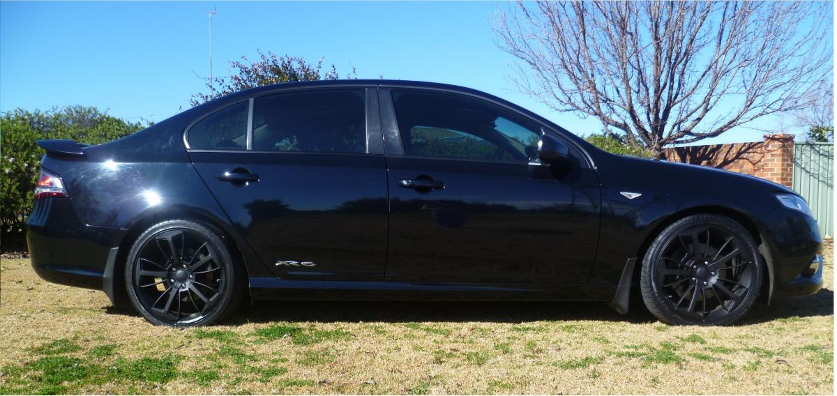

Hey guys I bought my FG in silhouette a about 2 months ago now and its got a lot of swirls in the paint to the point that you wouldn't even think there was metallic flake in the paint.
I spoke to a panel beater I know and for $300 he can do a cut and polish, but he said being black it needs to be done 3 times with 3 different pads to make sure no swirls are left. Now he's a mate of my old mans so I'd say he's not talking smack.
Now before I go ahead and pay the $300 (which I don't have at the moment lol) I was hoping to give it a crack myself. I've got a car buff to use (just a cheap supercheap one) would the pads that come with this be any good or should I buy different ones? Point me in the right direction please.
Also what sort of a polish should I be using? Probably something that cuts a bit aswell because the swirls are pretty bad. Also nothing over the top expensive because if it works out too much I'll get the panel beater to do it when I have some money.
Going to be giving it a wax after the polish so a good wax for silhouette would be good to know too.
Cheers guys!
You can see in these photos how bad it is! This was straight after it was washed
post-42825-0-47042200-1346671732_thumb.j
post-42825-0-68329200-1346671761_thumb.j

ok, those standard round cheap sh*t polishers are sh*thouse.
Only good for applying wax, if that.
Better of doing it by hand.
If indeed your paint is that farked, pay the man $300 and be on your way. A decent Random Orbital and polish (such as Poorboys, Menzerna etc - even basics like the Megiars range or Autoglym) and some decent pads will cost way more than $300. You could buy a cheap rotary sander/polisher and some decent polish and pads but being a black car you have every chance of burning the paint.
Rotaries are best left to people with some experience.
I myself have about $850 worth of polishes, waxes, machines and stuff.
Pay the man $300 and give him some beer. Polishing cars sucks.
google 'waxit car care' for a rough idea on how much stuff can cost for dickheads like me who can't just wash a car and be done with it.

Used to have a black WRX..
Since its still a reasonably new car consider trying something soft first.. Like meguiars deep crystal paint cleaner.. That's a very light cutting agent. Then give it a few coats of a good wax.. I personally used to use meguiars wet look crystal polish.. It was easy and made black cars stunning..
Alternately try clay bar?
Given the age of these cars I'd be cautious before cutting it 3 times..
