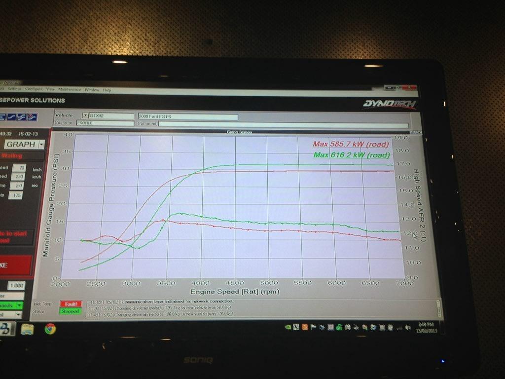

HIRO F6 Member 1,817 Member For: 16y 3m 6d Gender: Male Location: Brisbane, QLD Posted 14/02/13 09:57 PM Author Share Posted 14/02/13 09:57 PM Well "More to Come" is hopefully today.Tuning the GTX45 on E85 today. Have also replaced the EBoost street 30psi with a 40psi. Hoping to see a result deeper into the 600's. The twin 044's will hold us back but then next week we will be installing Process Wests new fuel system and hoping to get over the 1000hp mark.Will hopefully have a video to upload by tonight.Wish me luck 1 Link to comment https://www.fordxr6turbo.com/forum/topic/81480-fg-f6-ute-just-in-more-to-come/page/9/#findComment-1362951 Share on other sites More sharing options...

HIRO F6 Member 1,817 Member For: 16y 3m 6d Gender: Male Location: Brisbane, QLD Posted 15/02/13 05:23 AM Author Share Posted 15/02/13 05:23 AM I love watching the beast be dyno'd.Pump fuel tune made 453rwkw's @ 22psi. That's where we thought it should be.E85 made 616rwkw's @ 32psi. Still more in it but not with only 2x 044's. New fuel system will be here next week.Will try and get the video up tonight.Bring on Sunday! 1 Link to comment https://www.fordxr6turbo.com/forum/topic/81480-fg-f6-ute-just-in-more-to-come/page/9/#findComment-1363101 Share on other sites More sharing options...
