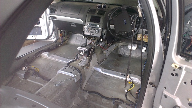

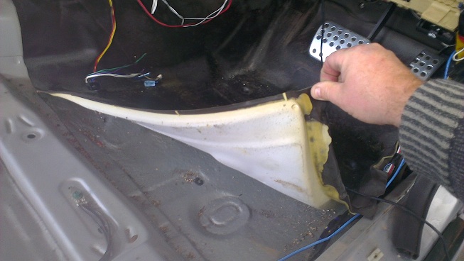

Panda Eyes flame magnet Gold Donating Members 5,674 Member For: 17y 27d Gender: Male Location: adelaide hills- 'race air' central Posted 04/08/12 07:22 AM Author Share Posted 04/08/12 07:22 AM started sound insulation today- beginning with vibration dampening:removed everything from inside the carthere is already some not bad sound/ heat insulation under the front carpeta good vacuum and the inside is ready. you could prepsol if you want, and I would recommend on any surface that has been polished, but under the carpet hasnt, so all good.the purists would hang me for not getting the old deadener off, but that could well involve 2-3 days of heat and scraper in hand, and tbh I dont think it will hurt any to leave it there.started to add deadening material to boot lid firstthen the boot itself, and rear quarter panelsim going with the new school way of doing it- 25% or so of panel coverage. gone are the days where it was beleived you need to put layer upon layer of the stuff on every square centimetre of the panel.this only adds weight, and cost to the build, for a difference that is not audible to the naked ear.so the results? hard to tell at this early stage, but one thing I have noticed- there is a 'dead' sound to the boot- when I stick my head in and speak, it does not echo at all. excellent for true sound reproduction. also when the boot is slammed shut, there is a nice deep thud, not the usual tinny rattle.tomorrow- the doors will get a dose of sound deadener... 1 Link to comment https://www.fordxr6turbo.com/forum/topic/80955-starting-new-stereo-build/page/7/#findComment-1274619 Share on other sites More sharing options...

Panda Eyes flame magnet Gold Donating Members 5,674 Member For: 17y 27d Gender: Male Location: adelaide hills- 'race air' central Posted 04/08/12 10:31 PM Author Share Posted 04/08/12 10:31 PM this is the first car ive done, so im kinda enjoying it... constantly tapping the panels as I go to see what difference there is... Link to comment https://www.fordxr6turbo.com/forum/topic/80955-starting-new-stereo-build/page/7/#findComment-1274794 Share on other sites More sharing options...
Panda Eyes flame magnet Gold Donating Members 5,674 Member For: 17y 27d Gender: Male Location: adelaide hills- 'race air' central Posted 05/08/12 08:09 AM Author Share Posted 05/08/12 08:09 AM (edited) continued with the sound deadening today, doors inside and out...also tidied up the factory wiring- cloth tape applied, and sticky cable tie mounts to stop the flapping around...also cloth taping all wiring in doors...the idea is to prevent rattling (obviously) but also to deaden echo and reverberation as much as possible. Edited 05/08/12 08:10 AM by Panda Eyes Link to comment https://www.fordxr6turbo.com/forum/topic/80955-starting-new-stereo-build/page/7/#findComment-1274999 Share on other sites More sharing options...
