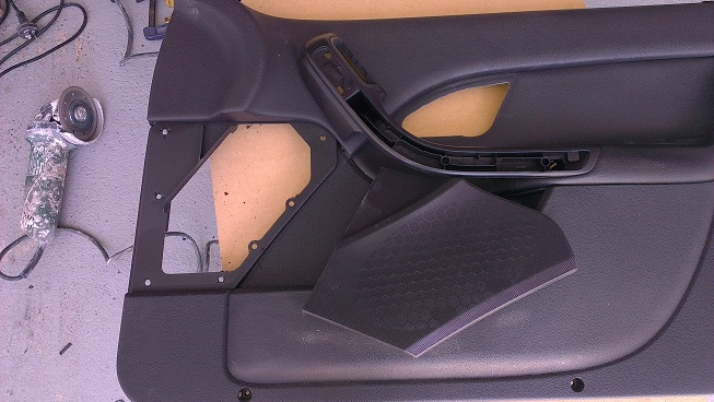

Panda Eyes flame magnet Gold Donating Members 5,674 Member For: 16y 7m 30d Gender: Male Location: adelaide hills- 'race air' central Posted 14/10/12 11:15 AM Author Share Posted 14/10/12 11:15 AM so some updates- I havent posted for a while, but have been steadily working on the build...started on the door trims:the speaker grills are plastic riveted to the door card, so I got my grinder out and nipped them offtime for tape and fibreglass. I sprayed the tape with cooking spray so the fibreglass will release.also remember to clean the areas to be taped thoroughly with prepsol or wax and grease remover, to get rid of old armour all etc. Link to comment Share on other sites More sharing options...
