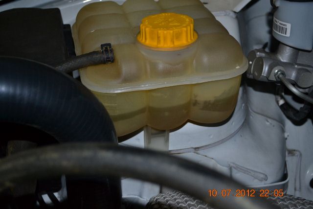

turbotrana Member 2,586 Member For: 22y 14d Gender: Male Posted 10/07/12 02:08 PM Share Posted 10/07/12 02:08 PM As I bought this car second hand I really dont know what the history is. Now its coming on 3y/o the coolant needs changing.Was the factory coolant yellow for some time in the FG or has this been definately replaced, or was it green and gone yellow? Picture attached. Link to comment https://www.fordxr6turbo.com/forum/topic/80926-what-is-the-factory-colour-of-a-2009-fg-coolant/ Share on other sites More sharing options...
601Turbz Member 111 Member For: 14y 7m 7d Gender: Male Posted 10/07/12 03:16 PM Share Posted 10/07/12 03:16 PM GREEN!Just flush it right out and replace. Link to comment https://www.fordxr6turbo.com/forum/topic/80926-what-is-the-factory-colour-of-a-2009-fg-coolant/#findComment-1265501 Share on other sites More sharing options...
EFSIX I Lead Not Follow... Member 1,026 Member For: 12y 11m 25d Gender: Male Location: Westside,Melbourne Posted 10/07/12 03:47 PM Share Posted 10/07/12 03:47 PM +1 buds its green but do as the guy above said,should have no dramas!Ive done the same but have put a really good coolant that was purchased from the states with very good results " FLUID XP - NANO - FR " the colour is flame red! very good results! Link to comment https://www.fordxr6turbo.com/forum/topic/80926-what-is-the-factory-colour-of-a-2009-fg-coolant/#findComment-1265503 Share on other sites More sharing options...
