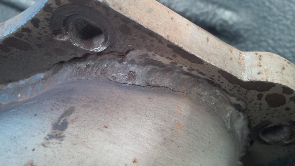

camo86T Silver Donating Members 1,810 Member For: 11y 4m 8d Gender: Male Location: SW Sydney Posted 15/02/16 06:36 AM Share Posted 15/02/16 06:36 AM (edited) Repaired my dump pipe again on Saturday Couple of brutal hits underneath had taken their toll I really should drag out the jig I made up years ago and have a crack at making a staino replacement Removed and inspected the cat at the same time, for some reason I'd had this idea that it was starting to sh*t itself, but looks ok to me for 40+K Edited 15/02/16 06:38 AM by camo86T incorrect photo Link to comment https://www.fordxr6turbo.com/forum/topic/80918-what-did-you-do-to-your-car-today/page/694/#findComment-1579655 Share on other sites More sharing options...
