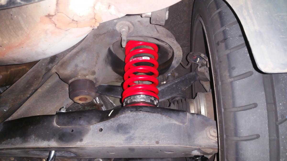

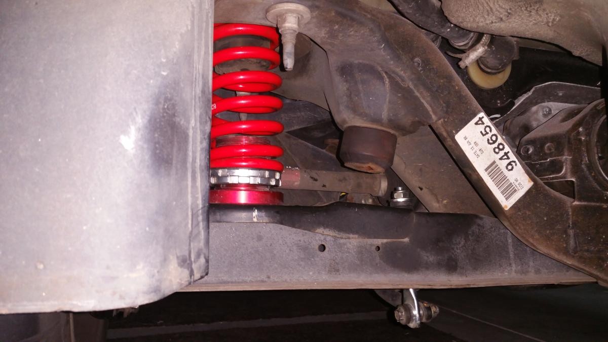

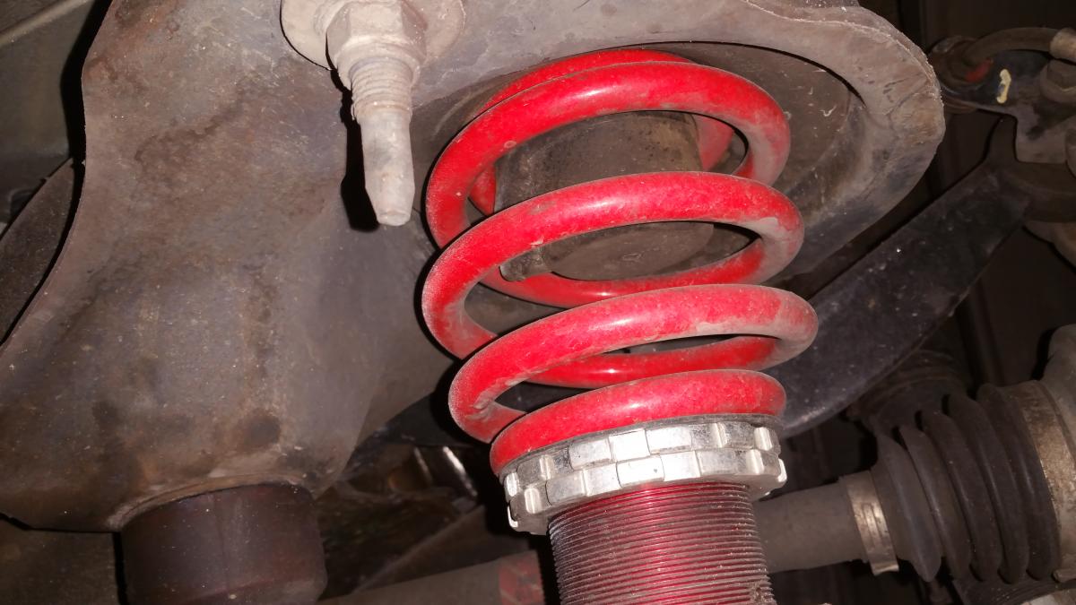

Ralph Wiggum Moar Powar Babeh Lifetime Members 19,331 Member For: 19y 6m 19d Gender: Male Location: Perth Posted 24/07/15 03:45 PM Share Posted 24/07/15 03:45 PM Retired the 4.5yr old rear springs and went with a set of Pedders Motorsport rears. Same spring rate as before (8KG) but slightly longer length (200mm vs 180) so it will be interesting to see the net effect on stiffness.The rears had sagged over the years and adding the optima battery in the spare wheel tub and sub/box hadn't helped the cause. My main goal was to regain some height adjustment and and so far in static height i've pick up aprox 15mm (have gone from 70mm hub to lip to 85mm, with an 18") which puts the rear control arm aprox 5mm above level, which is just how I like it.BeforeAfterkthnxby 4 Link to comment https://www.fordxr6turbo.com/forum/topic/80918-what-did-you-do-to-your-car-today/page/630/#findComment-1555423 Share on other sites More sharing options...
Tocchi Sandtrap Motorsport Donating Members 2,055 Member For: 16y 4m 18d Gender: Male Location: Perth Posted 24/07/15 04:30 PM Share Posted 24/07/15 04:30 PM They look good !!! So new.Talking about newish, how cleans that part number sticker Link to comment https://www.fordxr6turbo.com/forum/topic/80918-what-did-you-do-to-your-car-today/page/630/#findComment-1555426 Share on other sites More sharing options...

Ralph Wiggum Moar Powar Babeh Lifetime Members 19,331 Member For: 19y 6m 19d Gender: Male Location: Perth Posted 25/07/15 03:58 AM Share Posted 25/07/15 03:58 AM No need,bump stops are in the shocks. Link to comment https://www.fordxr6turbo.com/forum/topic/80918-what-did-you-do-to-your-car-today/page/630/#findComment-1555465 Share on other sites More sharing options...
HI PSI Member 1,586 Member For: 18y 10m 17d Gender: Male Location: Central Queensland Posted 25/07/15 08:39 AM Share Posted 25/07/15 08:39 AM On 24/07/2015 at 3:45 PM, Ralph Wiggum said: Quote Retired the 4.5yr old rear springs and went with a set of Pedders Motorsport rears. Same spring rate as before (8KG) but slightly longer length (200mm vs 180) so it will be interesting to see the net effect on stiffness.The rears had sagged over the years and adding the optima battery in the spare wheel tub and sub/box hadn't helped the cause. My main goal was to regain some height adjustment and and so far in static height I've pick up aprox 15mm (have gone from 70mm hub to lip to 85mm, with an 18") which puts the rear control arm aprox 5mm above level, which is just how I like it.Really keen to hear your thoughts on these, as my springs have sagged and need replacing..... Link to comment https://www.fordxr6turbo.com/forum/topic/80918-what-did-you-do-to-your-car-today/page/630/#findComment-1555491 Share on other sites More sharing options...
