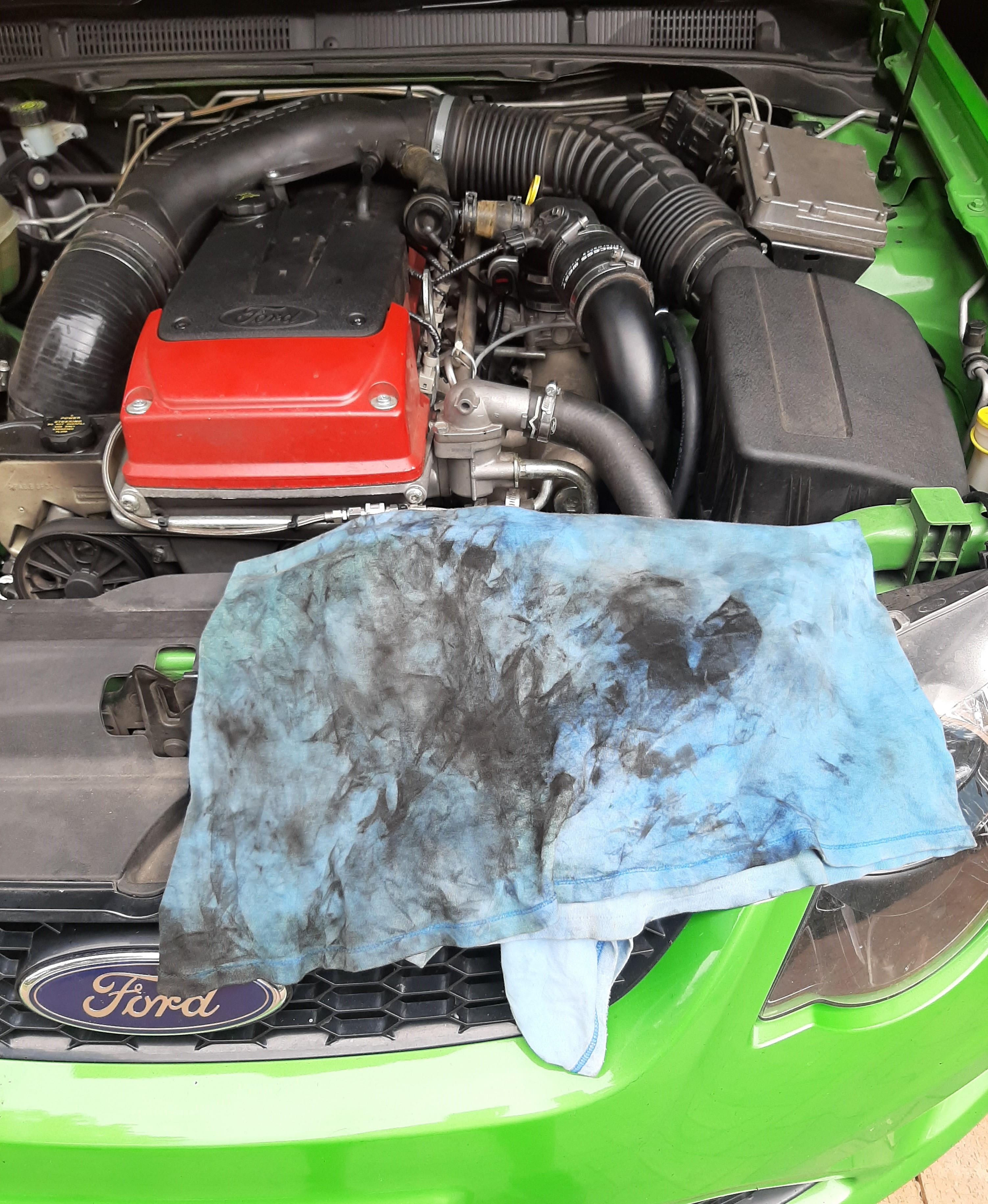

PAH Donating Members 361 Member For: 16y 3m 10d Gender: Male Posted 18/09/19 12:45 AM Share Posted 18/09/19 12:45 AM Guys, I cleaned the throttle body. It wasn't quite as black as the La Brea Tar Pits but it wasn't much better. https://en.wikipedia.org/wiki/La_Brea_Tar_Pits. I also added one earth from Battery Neg to the inlet manifold. It looks like that's cured the Battery Fail warning lights on the dashboard and the idle is a lot more stable. After adding only the one extra earth cable the car has stalled once at a red light with the engine at idle. I've just added another earth and hope that this totally nails the issue. With the one earth, the improvement is significant. I ran the second earth from Battery Neg to the fuse box earth. It's connected to a hole in the (painted) inner guard so I'm wondering if that's the poor earth point? It'd be nice to know where the factory earth is failing so it could be fixed at the source. Thanks heaps for this thread. Very helpful! And I now know to clean the throttle body every 20k or so. PAH PS: I've been told that injector cleaner kills oxy sensors so I don't use it any more. Does Throttle Body Cleaner kill oxy sensors? Link to comment https://www.fordxr6turbo.com/forum/topic/80902-fg-stalling-problem-fixed-i-think/#findComment-1688475 Share on other sites More sharing options...
