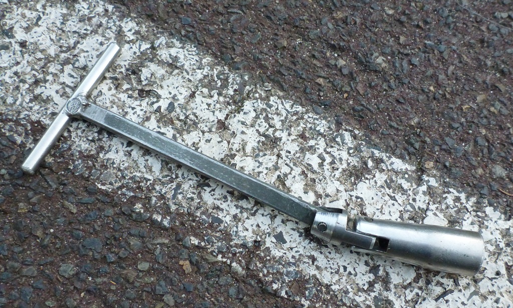

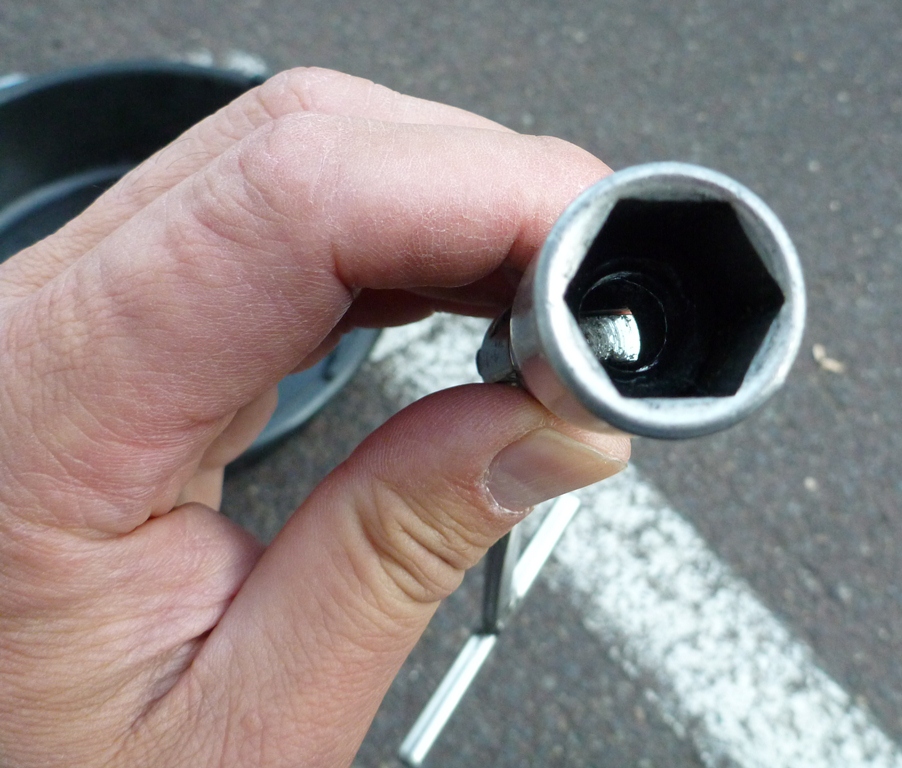

EvilDaifu Cruise Whore Moderating Team 5,130 Member For: 19y 8m 28d Gender: Male Location: Melbourne Posted 20/05/12 12:17 PM Author Share Posted 20/05/12 12:17 PM Some pics - enjoy Tool to easily extract spark plugs - note the joint in the handle for the 6th spark plug closest to the firewall in the engine bay (furtherest away from front). Helps to get the tool in place by bending it slightly - though still need the length to lower into the engine for the 6th spark plug. There is also a bit of rubber inserted inside the socket hole to suck around the end to hold the spark plug and make it easier to align as you lower the spark plug into the engine. I took a vid of it in use and how to clean the spark plugs (shows removal of coils and spark plugs) - will post up later 3 Link to comment https://www.fordxr6turbo.com/forum/topic/79715-xr6t-diy-day/page/19/#findComment-1240454 Share on other sites More sharing options...
