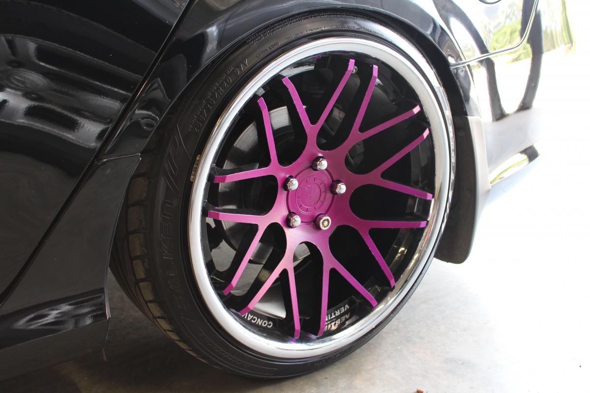

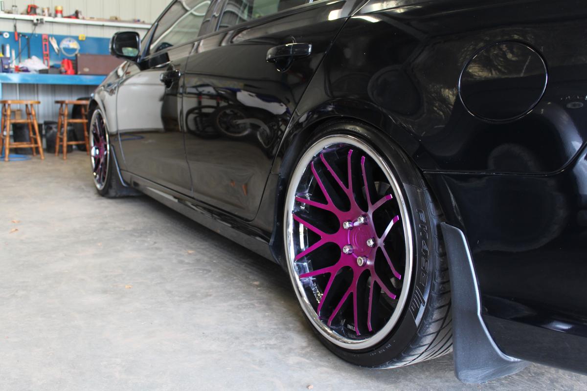

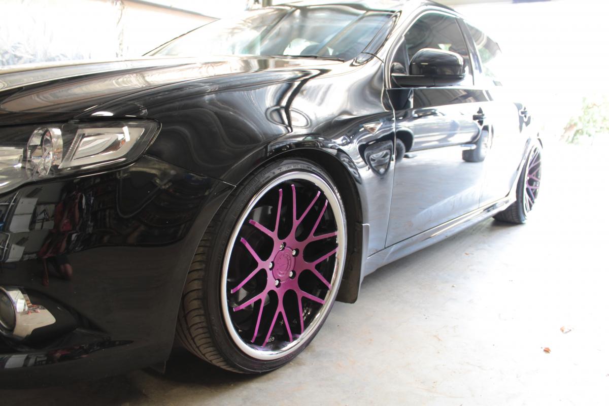

Bellato Donating Members 2,713 Member For: 14y 4m 15d Posted 11/02/13 01:48 AM Share Posted 11/02/13 01:48 AM (edited) Had a go at doing my wheels again, except this time didn't paint the whole things. It's blaze purple with a few coats of glossifier on topLet me know what you thinkAlso did my mrs wheels on her cruze the same but no pics because Expensive Daewoo lol Edited 11/02/13 01:48 AM by Bellato 9 Link to comment Share on other sites More sharing options...
Hotwire Donating Members 172 Member For: 16y 4m 20d Gender: Male Location: Adelaide Posted 11/02/13 02:40 AM Share Posted 11/02/13 02:40 AM I like it Link to comment Share on other sites More sharing options...
Henz Tampon inserted, Auto Acquired, next purchase a new handbag Donating Members 9,946 Member For: 16y 11m 14d Gender: Male Location: Vic Posted 11/02/13 07:21 AM Share Posted 11/02/13 07:21 AM That's a schmexy colour. Did you mask everything up or just peel it off? Link to comment Share on other sites More sharing options...
JETURBO ...JD TUNING ADELAIDE... Gold Donating Members 23,708 Member For: 16y 9m 3d Gender: Male Location: Adelaide Posted 11/02/13 07:25 AM Share Posted 11/02/13 07:25 AM that's kind of ok colour Did well bud !! Link to comment Share on other sites More sharing options...
Bellato Donating Members 2,713 Member For: 14y 4m 15d Posted 12/02/13 02:53 AM Share Posted 12/02/13 02:53 AM (edited) Thanks guys! Taped up everything henz and did light coats like normal, I thought the plastidip would cut itself on the spokes because they're sharp edges but it didn't do it like I wanted and when I took the tape off it left a bit of overspray peeled up on the inside of some of the spokes. So just went around with a sharp razor blade and cleaned it all up. The purple is definitely different to the can. I think the colour base of the wheel makes a big difference. My spokes were silver so the purple came out lighter. The gloss really brought the colour out more too. worth having a play withWhen I did my mrs I sprayed and peeled the tape straight away. Doesn't work as easily as it does in youtube videos lol. Edited 12/02/13 02:54 AM by Bellato Link to comment Share on other sites More sharing options...
