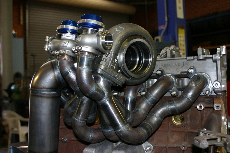

Ok so standard turbo decided to blow a seal. Damn. Lol. So just purchased a brand new gtx4202r. Etm is making me a manifold with twin gates and 5 Inch intake. Still waiting on m Donald bro s to give nod for 9 inch. Got
Some 1000cc injectors. Starting to come along now.

So it's been a while, things have been slow but slowly but surely getting there having a big change in plans now. I will be getting the car back from McDonald bros racing next weekend, ended up going full race 4 link setup, shortened strange 9" diff, 31 spline moser billet axles, Full spool and also got it mini-tubbed while it was there. Going to sell the c9 that's in it now and go with a Neil chance powerglide and converter from the states. Still unsure on engine may replace it with a 3.7 destroked motor revving to 9,000rpm due to mine only having standard diameter arp head studs. Really need 14mm. The fuel cell is sitting here waiting for the car to make it back so I can't start work on it. 1/2 inch lines throughout, process west fuel rail with a turbo smart fpr2000 regulator and I'd,2000cc injectors, also have (x2) 044 bosch pumps and an 909 bosch pump as a pre pump to a 2.5 ltr surge tank. I have photos of the exhaust manifold I will post shortly. Very impressive design and perfect flow design. Thanks again Leigh
