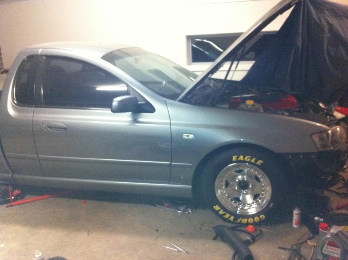

MYWPN Donating Members 554 Member For: 19y 10m 7d Gender: Male Location: Bendigo Posted 07/04/12 09:08 PM Author Share Posted 07/04/12 09:08 PM photos 1 Link to comment https://www.fordxr6turbo.com/forum/topic/79604-time-to-chase-that-ute-record/page/2/#findComment-1219607 Share on other sites More sharing options...

JVK Silver Donating Members 751 Member For: 19y 4m 21d Gender: Male Location: North West Hot Hell,VIC Posted 07/04/12 10:05 PM Share Posted 07/04/12 10:05 PM Is that a dry or wet Nos system and what hp jets have you tried so far? Do you have the nozzle mounted in the piping just before the t/b or in the t/b.Sorry for the million questions but am interested in putting a kit on a sedan.Cheers Link to comment https://www.fordxr6turbo.com/forum/topic/79604-time-to-chase-that-ute-record/page/2/#findComment-1219620 Share on other sites More sharing options...
Henz Tampon inserted, Auto Acquired, next purchase a new handbag Donating Members 9,946 Member For: 17y 1m 19d Gender: Male Location: Vic Posted 07/04/12 10:48 PM Share Posted 07/04/12 10:48 PM Which macdonald bros kit did you get? Have you installed it yet? Link to comment https://www.fordxr6turbo.com/forum/topic/79604-time-to-chase-that-ute-record/page/2/#findComment-1219623 Share on other sites More sharing options...

MYWPN Donating Members 554 Member For: 19y 10m 7d Gender: Male Location: Bendigo Posted 08/04/12 01:33 AM Author Share Posted 08/04/12 01:33 AM On 07/04/2012 at 10:05 PM, JVK said: Is that a dry or wet Nos system and what hp jets have you tried so far? Do you have the nozzle mounted in the piping just before the t/b or in the t/b.Sorry for the million questions but am interested in putting a kit on a sedan.CheersCan only use wet system with forced induction. Wet is adjustable fuel and nitrous solenoids. Dry is adjustable nitrous only and generally just bumps fuel pressure up( not knowing the quantity of fuel)Its mounted less than 10 cm in piping in front ofthrottle body,right in the centre of the intake tube. By using say 50-70 hp pill. The real world numbers are more than double that due to its cooling ability therefore ramping engine pOwer up. I have around 70 hp shot and make around 60-80rwkw gain. Link to comment https://www.fordxr6turbo.com/forum/topic/79604-time-to-chase-that-ute-record/page/2/#findComment-1219675 Share on other sites More sharing options...
MYWPN Donating Members 554 Member For: 19y 10m 7d Gender: Male Location: Bendigo Posted 08/04/12 01:41 AM Author Share Posted 08/04/12 01:41 AM On 07/04/2012 at 10:48 PM, Hens said: Which macdonald bros kit did you get? Have you installed it yet?The full 4link setup made for ba. Remove tank etc. the 4link is getting made up as we speak. And il arrange a 9 inch soon to go in. Hopeing to have it don't in next 2 weeks. It's not rubbed yet stainonigger. It's deceiving that photo. The wheels actually stick out of the guards and inch or so. That's the reason I even considered shortening diff Link to comment https://www.fordxr6turbo.com/forum/topic/79604-time-to-chase-that-ute-record/page/2/#findComment-1219678 Share on other sites More sharing options...
