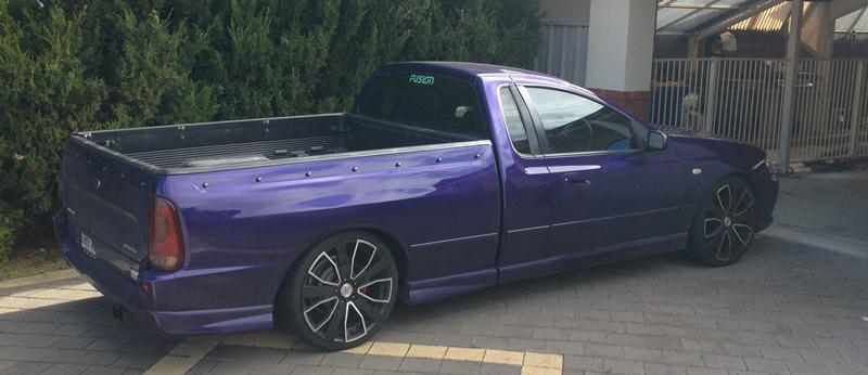

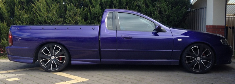

flathead01 Member 2 Member For: 13y 9m 22d Posted 06/04/12 05:12 AM Share Posted 06/04/12 05:12 AM This is on mine, reset leaves with 1" blocks and 17" wheels Link to comment Share on other sites More sharing options...
Wenier Donating Members 1,736 Member For: 14y 11m 23d Gender: Male Location: Christchurch, New Zealand Posted 06/04/12 06:30 AM Share Posted 06/04/12 06:30 AM Get some bigger wheels! That pic shows it so well, I know that the wheel shouldnt move any closer or contact the shock or mount but that 5-10mm is just so little. That is why I had my leaves reset rather than blocks. Link to comment Share on other sites More sharing options...
