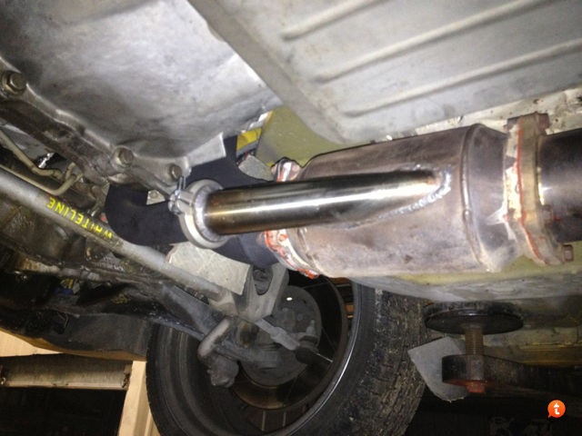

sr71 Member 52 Member For: 10y 11m 26d Posted 17/08/14 11:17 AM Share Posted 17/08/14 11:17 AM Nice write up. Would you mind explaining this " easily removable plumb back section ".Thanks Link to comment Share on other sites More sharing options...
Wilko16 Donating Members 1,672 Member For: 17y 4m 17d Gender: Male Location: Melbourne Posted 18/08/14 08:09 AM Share Posted 18/08/14 08:09 AM Is that still a real cat? Or just a pipe...That looks really funky haha Link to comment Share on other sites More sharing options...

trentlikeshp Member 63 Member For: 13y 2m 13d Posted 18/08/14 08:22 AM Author Share Posted 18/08/14 08:22 AM Nice write up. Would you mind explaining this " easily removable plumb back section ".image.jpgThanksit's a 4 bolt flange cat, so I can undo the screamer pipe and flange bolts, insert v band cap onto open plumb back port, rotate cat 180 degrees and bolt back together to have ext gate venting to atmosphere when ever I feel the needSent from my iPhone using Tapatalk 1 Link to comment Share on other sites More sharing options...
trentlikeshp Member 63 Member For: 13y 2m 13d Posted 18/08/14 08:23 AM Author Share Posted 18/08/14 08:23 AM Is that still a real cat? Or just a pipe...That looks really funky haha[/quoteyes that is a stainless high flow cat with no guts in it Sent from my iPhone using Tapatalk Link to comment Share on other sites More sharing options...
