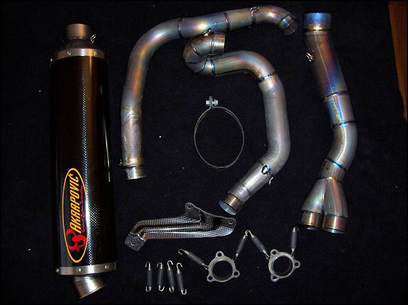

arronm Dropping a turd Gold Donating Members 9,520 Member For: 16y 10m 24d Gender: Male Location: Perth Posted 23/01/12 12:38 AM Share Posted 23/01/12 12:38 AM Titanium.Titanium.= Akrapovic. Link to comment Share on other sites More sharing options...
Ralph Wiggum Moar Powar Babeh Lifetime Members 19,323 Member For: 18y 11m 28d Gender: Male Location: Perth Posted 23/01/12 02:08 AM Share Posted 23/01/12 02:08 AM Titanium.Titanium.= Akrapovic.+1 titanium front section and mufflers for light wieght and heat resistance, Alumium rear section for more wieght reduction Link to comment Share on other sites More sharing options...
Pazzo Donating Members 11,132 Member For: 13y 10m 29d Gender: Male Posted 23/01/12 04:19 AM Share Posted 23/01/12 04:19 AM Had titanium headers right up to rear mufflers on my R1 when I had it, for a bike farkin expensive hate to think how much for a car. Link to comment Share on other sites More sharing options...
Dillz Three pedals are better then two.. Donating Members 15,637 Member For: 17y 3m 25d Gender: Male Location: Melbourne Posted 23/01/12 05:11 AM Share Posted 23/01/12 05:11 AM They crack easy too don't they? Not recommended on street cars. Link to comment Share on other sites More sharing options...
