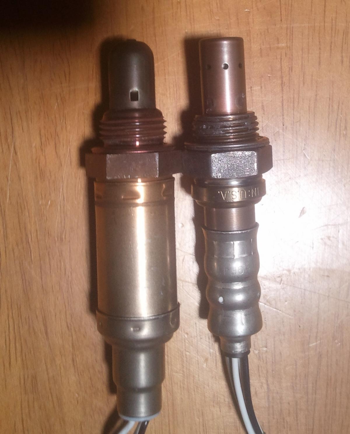

Falky100 Donating Members 305 Member For: 13y 5m 19d Gender: Male Posted 24/01/12 07:06 AM Author Share Posted 24/01/12 07:06 AM well. The performance mob told me he was 95% sure coils were the problem. He also says it was running good.BUT....Rarely when I pull up to lights for a period of time, or when I pull up in the driveway to let my car cool down. The revs drop about half a needle thickness or so and the car sits there and shakes. And all of a sudden the car will jump up 2 needle thicknesses and be idle normally...Also on one occasion when I pulled up in the driveway, the car would have little surging fits every minute or so.Now, dont get me wrong, after the coil packs, the car idles WAY better. Its just this last little hiccup I need to sort out now...My senses are still thinking its that dreaded non-genuine upstream o2 sensor. I havent checked to see if any codes have been logged yet. But when I get a minute il be going out and checking.John.P.s. Sorry to dissapoint you Dave in thinking my car is fixed! Im pissed aswell mate! Link to comment https://www.fordxr6turbo.com/forum/topic/78522-bad-idlep1311-lack-of-upstream-flow-o2-sensor-indicates-running-le/page/2/#findComment-1185309 Share on other sites More sharing options...
Falky100 Donating Members 305 Member For: 13y 5m 19d Gender: Male Posted 27/01/12 04:37 AM Author Share Posted 27/01/12 04:37 AM (edited) Well fellas, bought a GENUINE hego o2 sensor and fitted it today (what a bitch of a job! that heat shielding is razor sharp, took chunks out of my hand in 10 places!!) and when I saw the difference in shape size etc etc I nearly fell over thinking that my mechanic would have known better than to put cheap "totally different looking" sensors in my car. In the 4-5km drive that I took the car on afterwards, the car seemed to idle alot smoother (time will tell, il give it a week).Anyway, I took a pic to show everyone the difference in the sensors. Genuine ford being on the right. And the non genuine "delphie" I think the brand is being on the left.Cheers, John. Edited 27/01/12 04:37 AM by Falky100 Link to comment https://www.fordxr6turbo.com/forum/topic/78522-bad-idlep1311-lack-of-upstream-flow-o2-sensor-indicates-running-le/page/2/#findComment-1186512 Share on other sites More sharing options...
MX Dave Donating Members 545 Member For: 14y 24d Gender: Male Posted 27/01/12 11:22 AM Share Posted 27/01/12 11:22 AM Best of luck. Thanks or the photos. Fingers crossed ay Link to comment https://www.fordxr6turbo.com/forum/topic/78522-bad-idlep1311-lack-of-upstream-flow-o2-sensor-indicates-running-le/page/2/#findComment-1186754 Share on other sites More sharing options...
