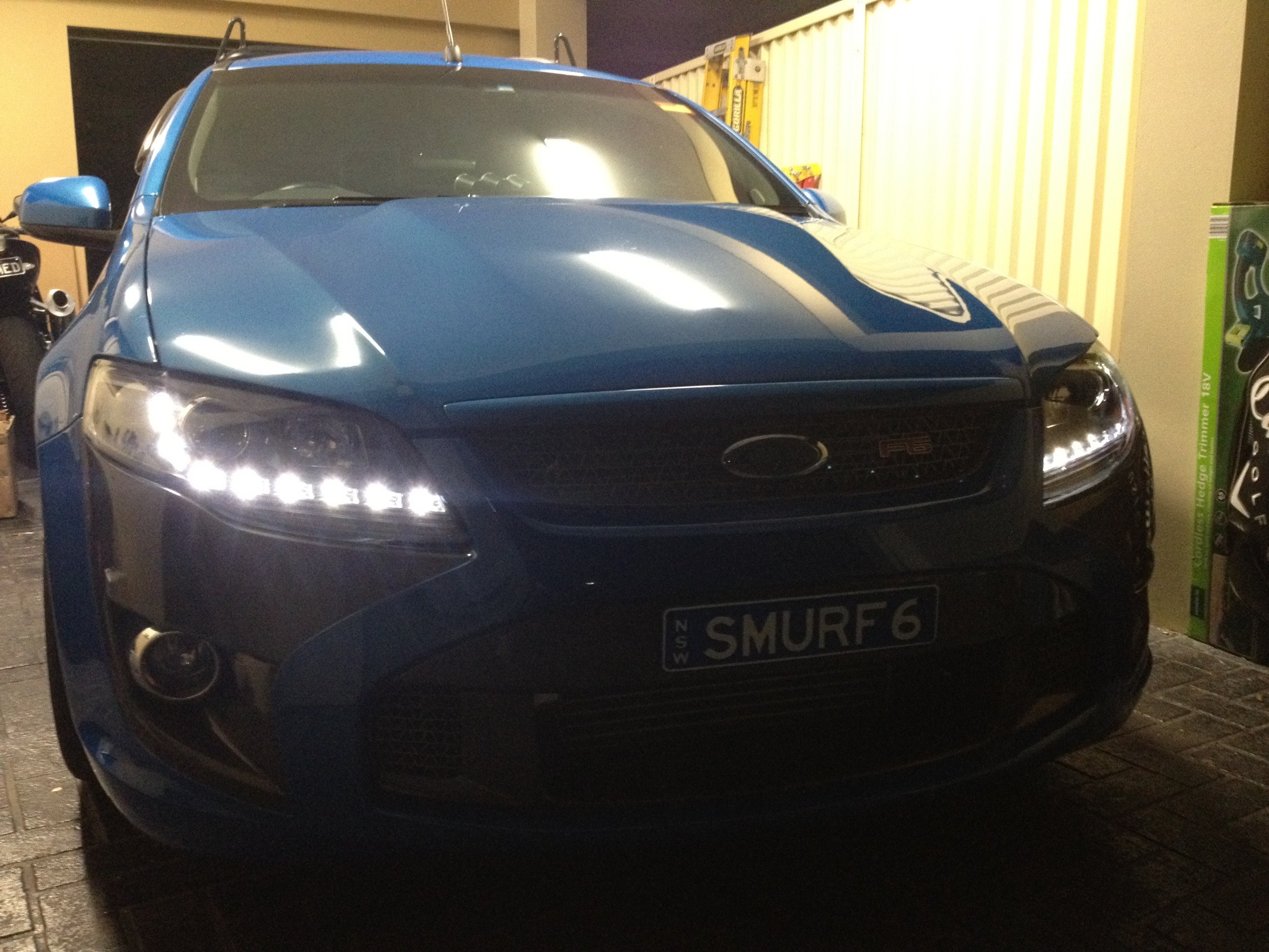

SMURF6 Jamie Donating Members 380 Member For: 16y 3m 7d Gender: Male Location: Maroubra, Sydney, NSW Posted 16/01/12 10:00 PM Share Posted 16/01/12 10:00 PM I'm loving my DRL headlights. I would buy the original mk2 projector headlights but I really think they should have come out with DRL's on them which forced me to buy the aftermarket ones. They cost me $450 picked up. 1 Link to comment https://www.fordxr6turbo.com/forum/topic/78437-fg-and-fg-mk2/page/3/#findComment-1181750 Share on other sites More sharing options...
