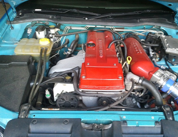

Ciaran Thooperrrrrrr Donating Members 2,768 Member For: 13y 10m 28d Gender: Male Location: NOR, Western Australia Posted 13/02/12 11:22 AM Share Posted 13/02/12 11:22 AM Not only is the outside of your car almost a Twin to Lukes, but your engine bay looks almost the same too rofl. Link to comment https://www.fordxr6turbo.com/forum/topic/78419-loss-of-power/#findComment-1195666 Share on other sites More sharing options...
