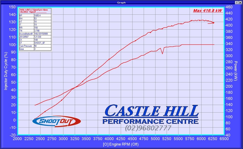

Dale@CHE Member 52 Member For: 16y 7m 8d Posted 06/05/12 11:57 PM Share Posted 06/05/12 11:57 PM On 06/05/2012 at 1:04 PM, JETSNOT said: again neat e85 and 1 044/+intank will do the trick for 400rwkw , if the tuner cant do it see another because theres heaps that can with excellent rep's oh and that should be say 129mph at the small end of the scaleyeh got plenty of fg's running 130+ but the fuel systems are done my way, one of them has done 80,000km on eflex and the tune hasnt been touched in 2 years and it only runs 131mph on street tyres.. I just dont agree with under doing fuel systems on ethenol.. there is not a great deal of room for error with it, if people want to run on the edge then that's there call but I wont do it to my customers cars espically ones that get used at the drags or on a circuit..anyway old mate will be here in 45min.. will see what it makes.. if it runs 129mph I would expect it to make 410-420rwkw so we will see. be good info for everyone any way as ill log the injector duty Link to comment https://www.fordxr6turbo.com/forum/topic/77949-e85/page/18/#findComment-1232983 Share on other sites More sharing options...

Dale@CHE Member 52 Member For: 16y 7m 8d Posted 07/05/12 02:40 AM Share Posted 07/05/12 02:40 AM 421rwkw on 21psi injectors maxedreflashed tune in to make sure right tune was loaded416rwkw on 22psi injectors maxed even more..this is with 55psi base fuel pressure not 40psi like I usually run, as I said the 100lb max at 420rwkw on 40psi base..ill put graphs up after lunch 2 Link to comment https://www.fordxr6turbo.com/forum/topic/77949-e85/page/18/#findComment-1233044 Share on other sites More sharing options...
Dale@CHE Member 52 Member For: 16y 7m 8d Posted 07/05/12 02:55 AM Share Posted 07/05/12 02:55 AM here is the graphhttp://www.castlehillexhaust.com.au/files/FGinj.jpgcar is running leaner than I would personally would run it on this boost,if I was doing this car I would have 40% larger injectors as it sits now which gives it 120lb the way it is to regain control of the injectors and get the mixtures back to what I would normally run, but with future mods the 160lb are really the best option.. Link to comment https://www.fordxr6turbo.com/forum/topic/77949-e85/page/18/#findComment-1233047 Share on other sites More sharing options...
