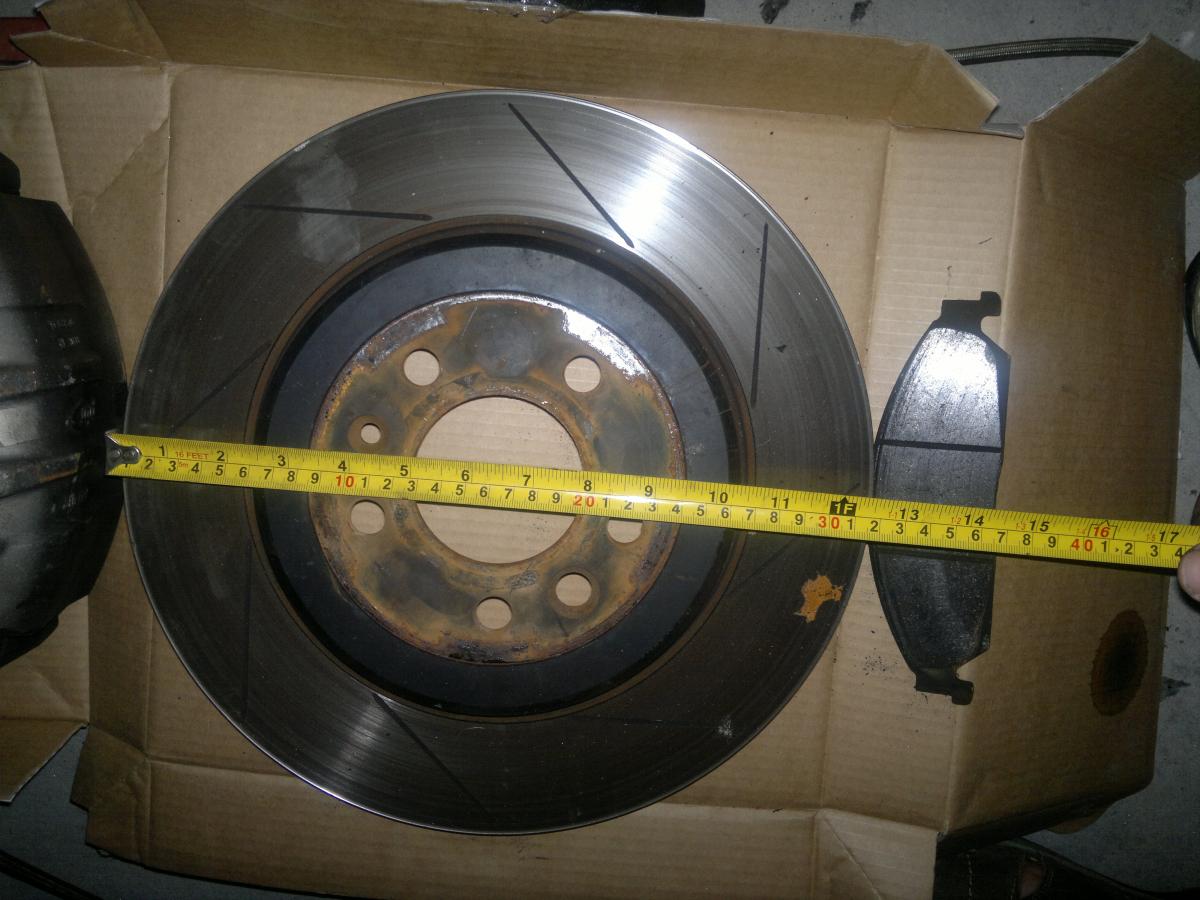

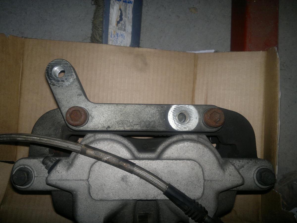

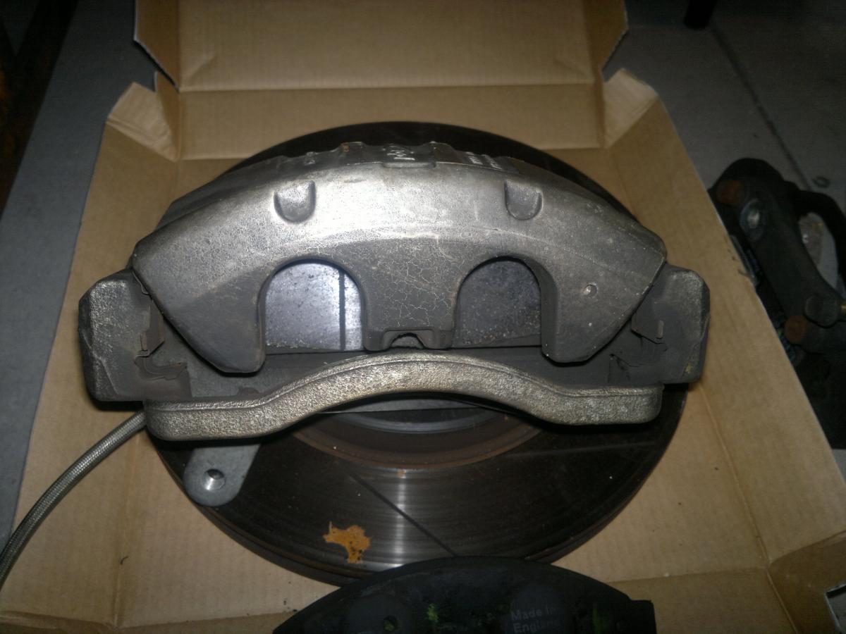

Ralph Wiggum Moar Powar Babeh Lifetime Members 19,332 Member For: 19y 7m 14d Gender: Male Location: Perth Posted 17/11/11 10:02 AM Share Posted 17/11/11 10:02 AM Pics of the caliper brackets and discs: Link to comment https://www.fordxr6turbo.com/forum/topic/77794-ba-premium-brake-brackets/page/3/#findComment-1160723 Share on other sites More sharing options...
Gojeep Member 20 Member For: 13y 5m 22d Posted 17/11/11 10:27 AM Author Share Posted 17/11/11 10:27 AM StrI did this upgrade about 4 years ago. Ford uses the PBR C6 caliper, not the older C5. Unless you know someone at PBR, I don't think you can get the caliper brackets on their own. I got the front caliper kit from PBR which was minus the hoses and hose brackets. You will need different hose brackets. The only place I could get them from was Ford who wanted around $55 each while the standard hose bracket was under $10.You are very right there and even had it mentioned in my write up linked above from years ago. Forgot the details some where along the way!Pics of the caliper brackets and discs:Thank you for those photos Luke. They are the BF XR8 322 rotor ones and have the same caliper that I already have. You were right there. Link to comment https://www.fordxr6turbo.com/forum/topic/77794-ba-premium-brake-brackets/page/3/#findComment-1160732 Share on other sites More sharing options...
Ralph Wiggum Moar Powar Babeh Lifetime Members 19,332 Member For: 19y 7m 14d Gender: Male Location: Perth Posted 17/11/11 10:38 AM Share Posted 17/11/11 10:38 AM Yeah as i mentioned you could reuse you old caliper with the larger disc. There's f-all differance in pad size between the standard/c5/c6 just the larger disc. The brackets are for sale if you want too go that way (you can have the disc's if you happy too pay the frieght)Oh and from a LandRover Fan Pics of Jeep???? Link to comment https://www.fordxr6turbo.com/forum/topic/77794-ba-premium-brake-brackets/page/3/#findComment-1160739 Share on other sites More sharing options...
